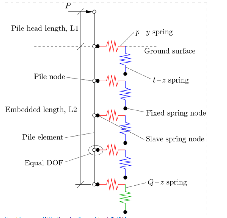

I also add an image of what I want to model. (https://opensees.berkeley.edu/wiki/inde ... Foundation)

From the image, you are referring to the modeling of soil as a series of equivalent springs.
In the model instead you are modeling the soil with continuum elements.
