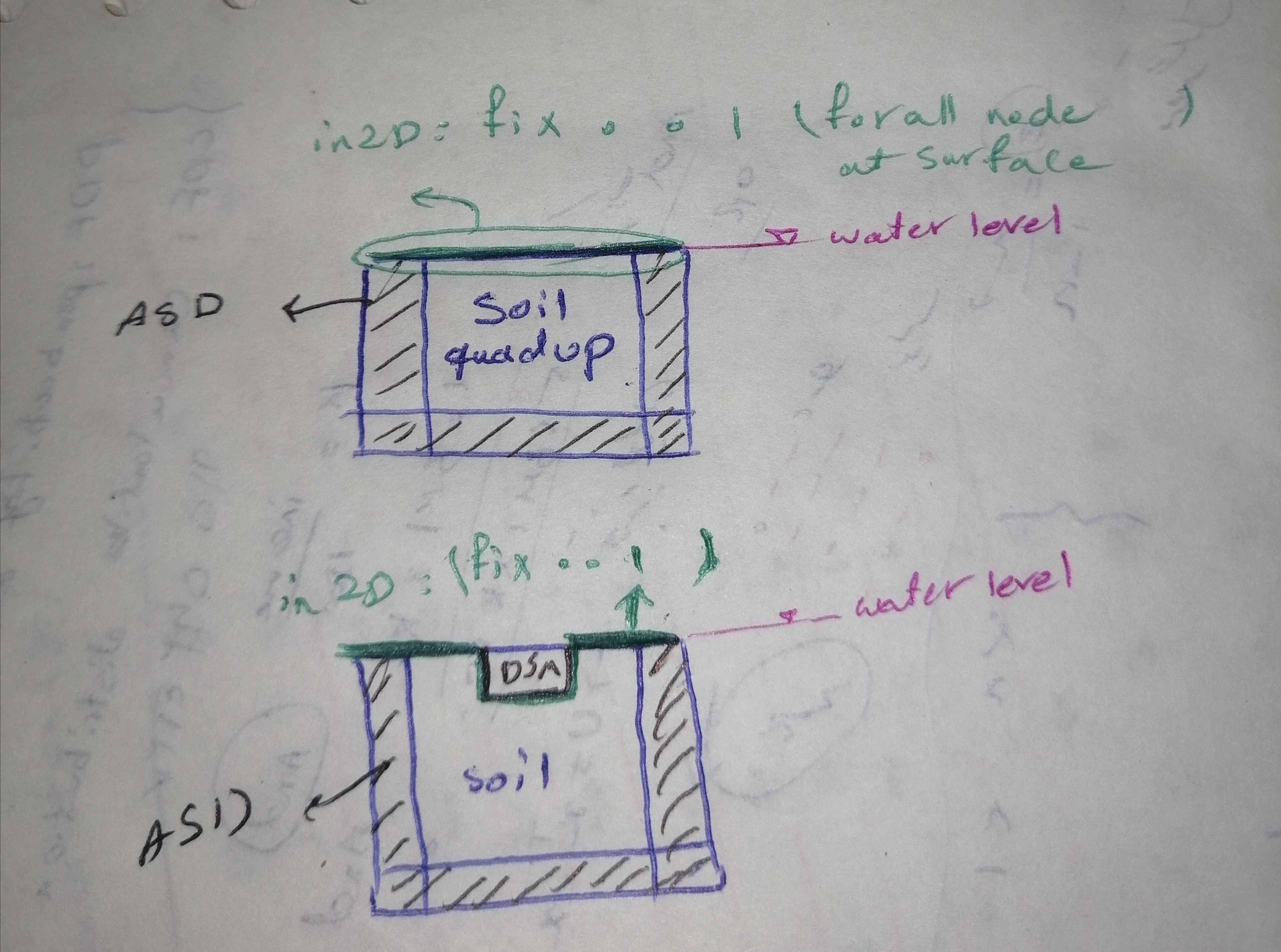

Re: Asd absorbing boundary conditions and saturated media
Dear stko
Thank you for your reply.
I attached two picture of my model.
In 2D and saturated media i used:
Element:quad up
Material:PDMY
And asd absorbing boundary.
finally i want to define block deep soil in my models.
Acoording to pictures have i defined boundary condition correctly in undrained domain?
Thanks
It seems fine.
Do this: try to use a simple Elastic Material and see if you obtain the expected results.
