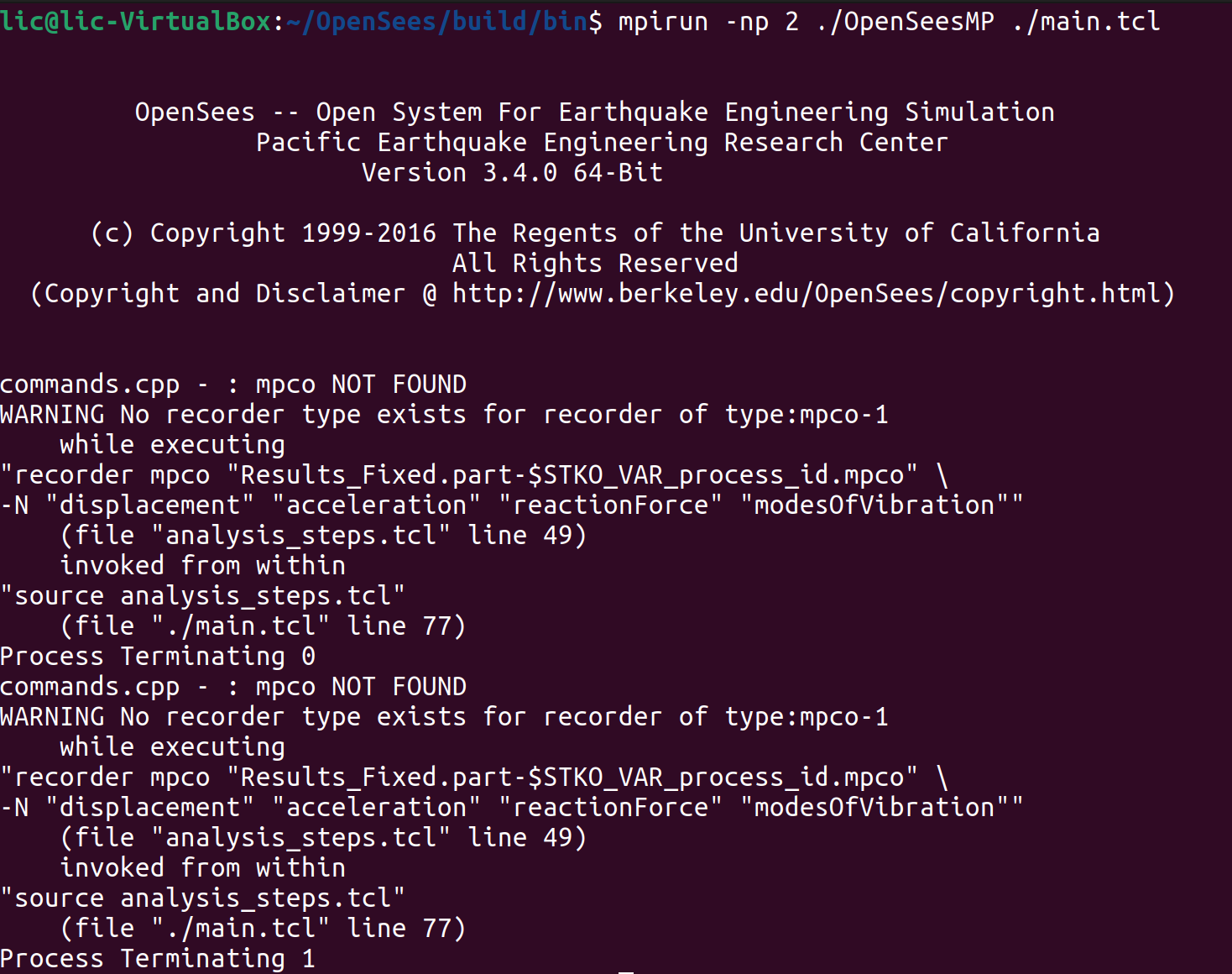

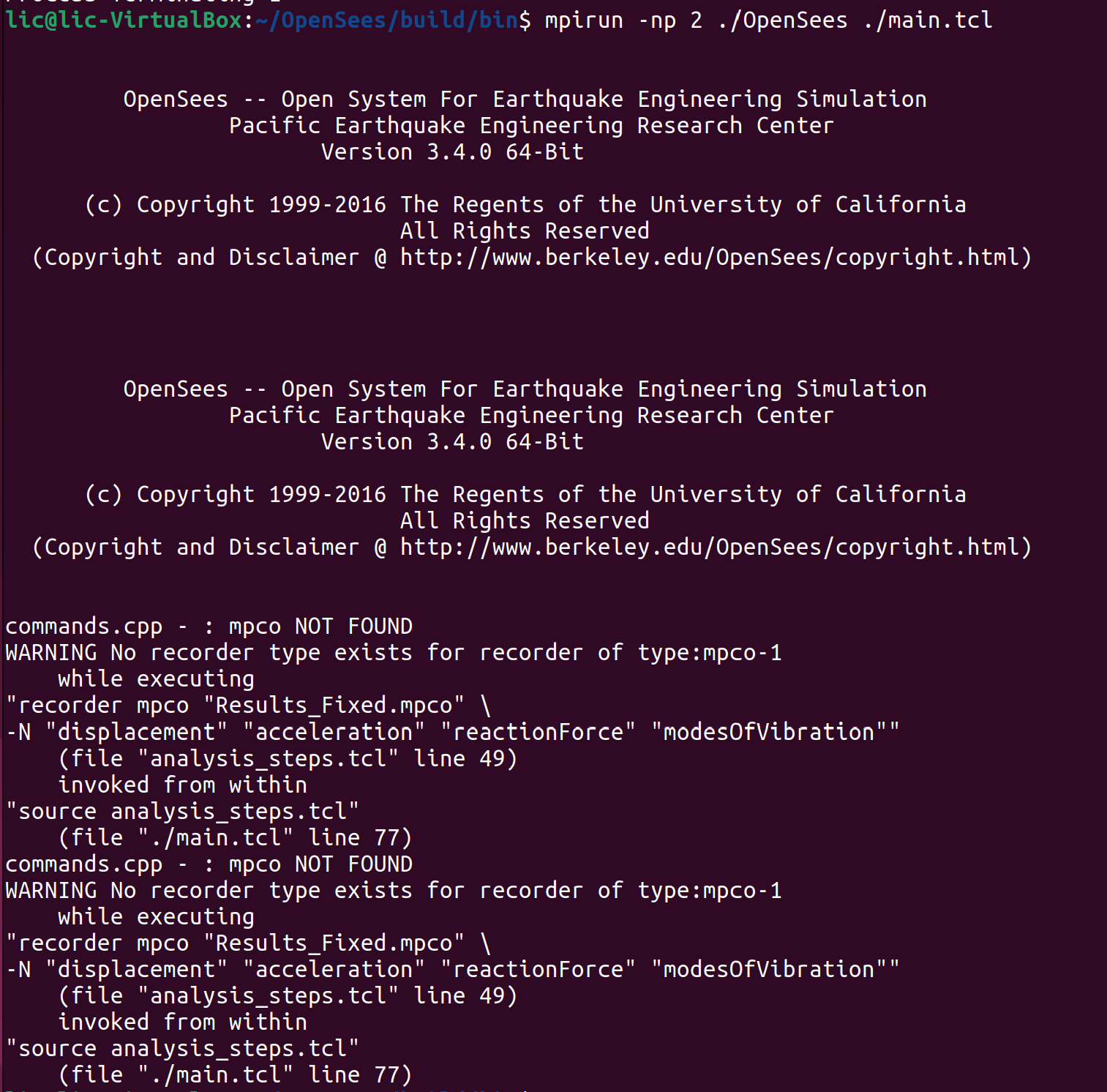

I'm currently working on a STKO model, and I need to be run it on Ubuntu.
I transferred the files from STKO on Windows to Ubuntu OpenSeesMP, but I'm now stuck on an MPCO recorder issue that I've been researching without success. Perhaps the current version of OpenSees does not support it, forcing you to use an earlier version. Could you please clarify that to me?

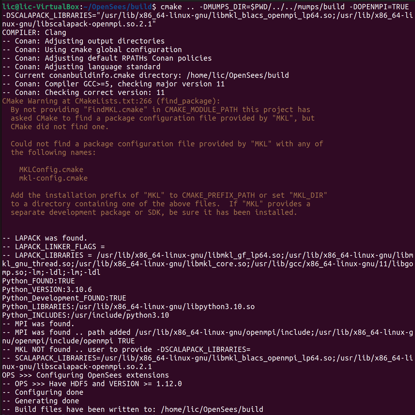

I attempted to directly compile Opensees using the Makefile.def, but I ran into numerous issues during the installation process. I tried to install it using Ubuntu 18, 20, and 22 in many different ways, and none of them were successful.
Eventually, I was able to get it working, but there were repeated warnings, and when I tried to replicate Opensees examples, it didn't perform as expected.
Fortunately, I found another approach online that involves installing it using Conan. The used tutorial is available here:
https://opensees.github.io/OpenSeesDocu ... tml#ubuntu
I noticed various warnings about MKL throughout this installation process, which I share in the picture attached.

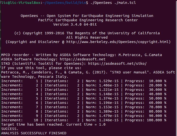

When I have opensees installed from the above tutorial despite the MKL warning I was able to successfully test Opensees examples using both Opensees and OpenseesMP. The examples I tried did not have MPCO recorder. This issue only arises when I attempt to run STKO output files. To troubleshoot this issue, I have tried a lot of different approaches, but so far without success.

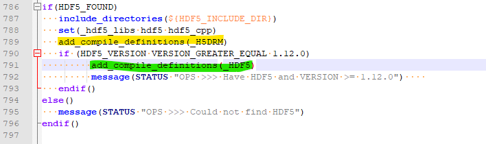

So if you are using Cmake, you need to fix a line in the OpenSees/CMakeLists.txt ( I will change it soon, they are still working on the Cmake part... )
You have to move the YELLOW line (_H5DRM flag) above as in the above picture.
The add the green line (_HDF5 flag).
