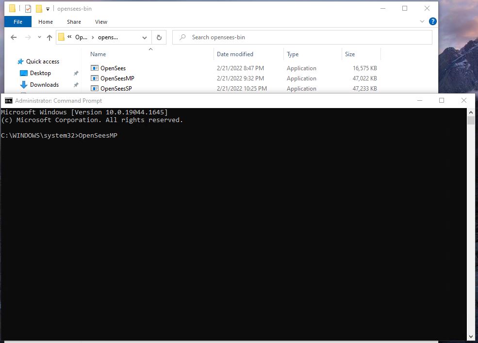

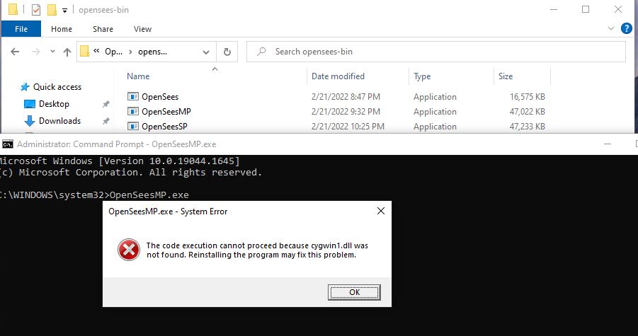

So, now I am using 2 strong PCs to improve efficiency during parametric study. Is it possible to export tcl script from STKO to run in another PC by using Opensees MP?
I tried to run OpenSees MP.exe from Professor Nicola Tarque as in attached Figure 1 (I already set the path for Environment Variables), then source to Analysis file to run the model. but there was an error when opening OpenSees MP.exe as in Figure 2.
How can I solve it?

Yes, you can.Is it possible to export tcl script from STKO to run in another PC by using Opensees MP?
You don't have to call directly OpenSees.exe. Instead, you have to use the dedicated batch file "openseesmp.bat" which sets up your environment for running OpenSeesMP.I tried to run OpenSees MP.exe from Professor Nicola Tarque as in attached Figure 1 (I already set the path for Environment Variables), then source to Analysis file to run the model. but there was an error when opening OpenSees MP.exe as in Figure 2.
As an example, assume the followings:
- The working directory is C:\SomeWhere
- The file to run is main.tcl (located in the working directory)
- You are using the OpenSees-Solvers from prof. Tarque's website, installed in C:\OpenSees-Solvers
- You want to use 10 processors
Open a command window
In the command window write: C:\OpenSees-Solvers\openseesmp.bat .\main.tcl 10

I used the calculate command from the cmd window that you recommended. But my computer reports an error. This error is the same as the one reported in the error software. It should be related to the fact that my computer cannot calculate in parallel. This problem has been tying me up for a long time. I hope to get your guidance.
C:\Users\Administrator>C:\OpenSees-Solvers\openseesmp.bat .\main.tcl 20
"RUNNING AS PARALLEL"
0 [main] mpiexec.hydra 11200 cygwin_exception::open_stackdumpfile: Dumping stack trace to mpiexec.hydra.exe.stackdump
0 [main] mpiexec.hydra 3240 cygwin_exception::open_stackdumpfile: Dumping stack trace to mpiexec.hydra.exe.stackdump
Re: STKO with Supercomputer
Can you share you STKO file?
