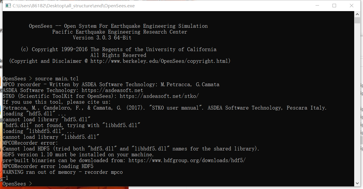

After STKO produces the 7 .tcl files, I try to run the main.tcl file in the opensees window, but it can't run.
How to run the 7 files correctly in opensees?
Please!

- 393fe141bab7de74583dca5990d1bc5.png (87.27 KiB) Viewed 14033 times

Probably because in the analysis_steps.tcl file you have left the MPCO recorder instructions.
If you want to start opensees manually by doing 'source main.tcl' you have to change the recorder instructions in the analysis_Steps.tcl file and use the opensees own ones:
https://opensees.berkeley.edu/wiki/inde ... er_Command
If instead you want to start opensees manually by making some manual changes to the code and you want to take advantage of the MPCO recorders and the STKO post processor, you should follow the instructions that have been given here:
viewtopic.php?f=27&t=73

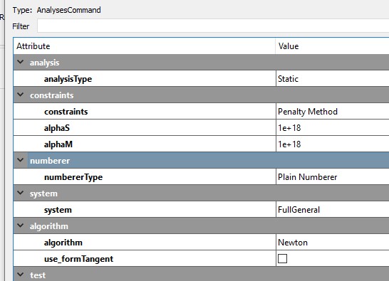

coming back to this query, would you agree with the attached Analysis settings to derive the full stiffness matrix (K) from STKO? Then K is derived via this custom command: printA -print -file "K_matrix.txt"
If the settings above are correct, then to derive the modal stiffness matrix of mode x (k_x), I should assemble the translational and rotational eigenvectors in the following form for each node (3D, so 6dof), per mode x:
phi_x = [phi_trans_node_1, phi_rot_node_1, phi_trans_node_2, phi_rot_node_2, ...].
where: phi_trans_node_i = [ux, uy, uz] & phi_rot_node_i = [rotx, roty, rotz]; as given in the mpco file.
After that: k_x = phi_x.T * K * phi_x
Could you please comment on the validity of the above?
