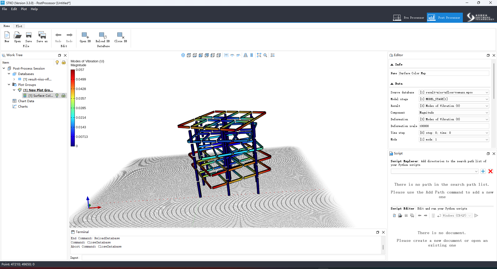

Dear STKO team:
I built a 3D frame model and used 'RCJonitModel3D' in it, but when I did time history analysis I found that the structure didn't seem to be connected together properly and the mode of vibration were clearly wrong as shown in the picture. I've tried adjusting the K(penalty) value of 'RCJonitModel3D' and using different constraint methods in the 'AnalysesCommand' but that doesn't work, how should I adjust the model so that the joints are connected correctly? Can you help me check the model? The model file is in the attachment. Thanks in advance.

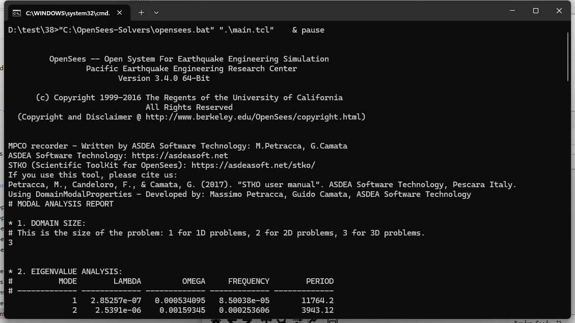

It's because if you use the RCJoint and the rigid diaphragm together, you cannot use the transformation handler!
You should go with penalty.
And also, the analysis to setup the eigen should not have the "wipeAnalysis" otherwise it will be useless
