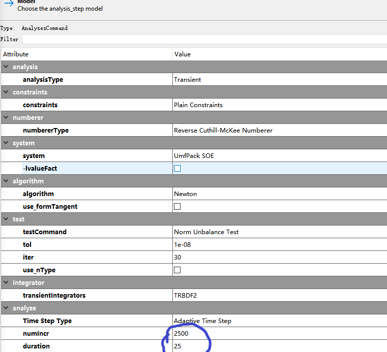

Dear STKO team, when I try to use openseesMP to parameterize my model for running parametric analysis, there is a problem that troubles me. How to parameterize the duration of ground motion and the numIncr, because there are so many timeseries (which describe different ground motion) and the duration of them are different.
parameterize duration.png (24.31 KiB) Viewed 922 times

You can do it but you need a custom tcl script.
Have a look at this example
param_time.zip
(83.29 KiB) Downloaded 182 times
