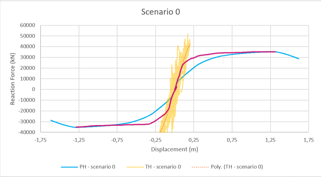

Correct me if I'm wrong but shouldn't I get a curve similar to the one in pink?
At least is the idea I have, or have a TH analysis that follow the blue line I have.. I just saw some examples and they were matching.
PH vs TH.PNG (61.88 KiB) Viewed 2802 times
Re: Pushover Analysis
Post by STKO Team » Wed Jan 24, 2024 9:08 am
No, if you look at your pushover results with the correct nodes for extracting all the reactions you will see a much higher pushover curve (if I remember correctly the shape was nearly linear and it reached values of about 400k).
Now if you put that curve under the TH response (always with the correct selection set) you will see that they match, at least in terms of stiffness, but your input motion is not strong enough to push it to the pushover displacement

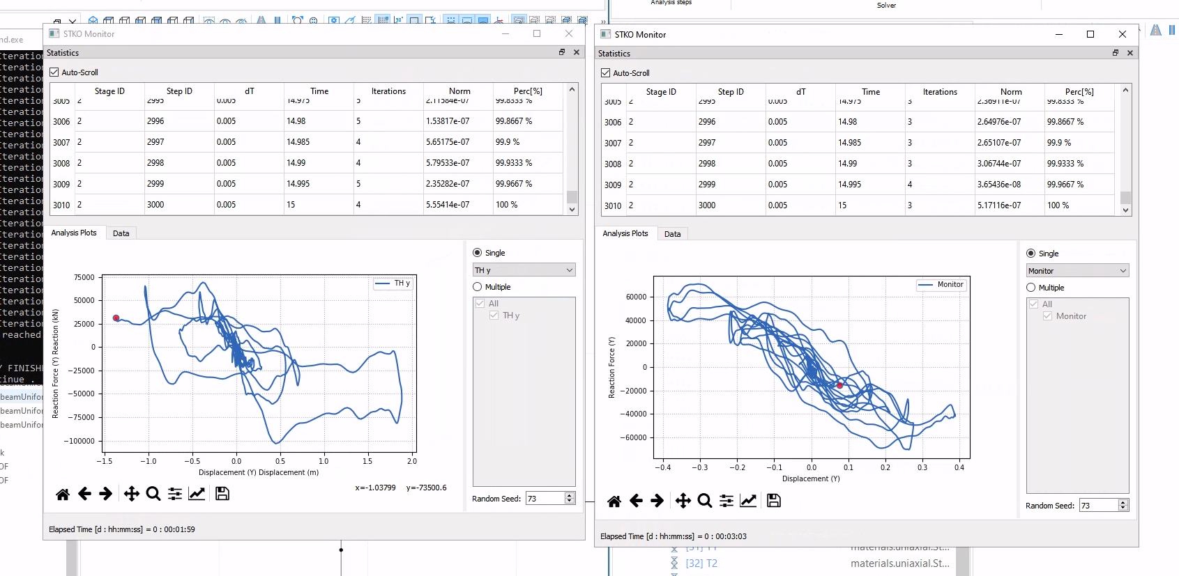

I have another question related to this topic: on my TH analysis I followed the youtube tutorial about the Non linear TH analysis of a bridge.
I have all the settings the same way as the example, but still can't have the same type of nonlinear analysis as the example.
I've checked, I am comparing the same selections sets, I also checked all the commands and still, my curve has a lot of noise and is not as defined as the one from the example.
Do you know what the mistake can be?
(image: tutorial graph example on the right side)
Post by STKO Team » Thu Jan 25, 2024 9:01 am
I did this, and you're right, it matches.
Ok perfect. That's a starting point.
Just one clarification: Is it the same model?
Post by sribeiro » Thu Jan 25, 2024 9:12 am
Is the same model I presented before.
I made it following the youtube tutorial, so connections are equal, material props very similar. Changes the geometry (shorter bridge) and the sw loads and the bearing props.
