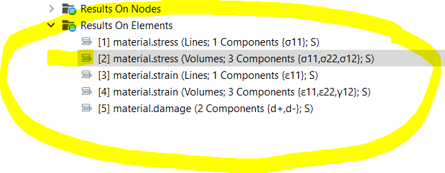

Could you please make a screenshot of your element results?:
Do you have a result that starts with this "material.stress (Volume; 3 Components {σ11,σ22,σ12};S)"?
gaetano_cmr
Posts: 7
Joined: Sat Sep 10, 2022 2:28 pm
Re: Retrieve stresses on GaussPoint
Post by gaetano_cmr » Fri Dec 16, 2022 9:08 am
Yes, I have it in my model as result; here the screenshot of my elements recorders:
Post by STKO Team » Fri Dec 16, 2022 2:46 pm
There is a missing white-space at the end ";<missing_here>S"

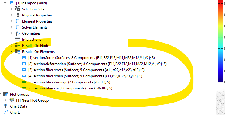

Extracting all available volume-based stress and strains
strain = db.getElementalResult('strain (Volumes; 6', match=MpcOdb.Contains)
stress = db.getElementalResult('stress (Volumes; 6', match=MpcOdb.Contains)
• To get elements results for stress and strains as displayed above, custom recorders each with value “stress” and “strain” needs to be kept in analysis step of preprocessor.
• Strain and stress variable in the code above extracts all stress and strains values of index [3] and [4] of figure above.
