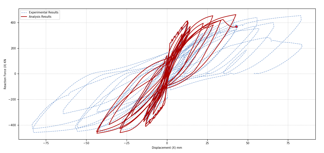

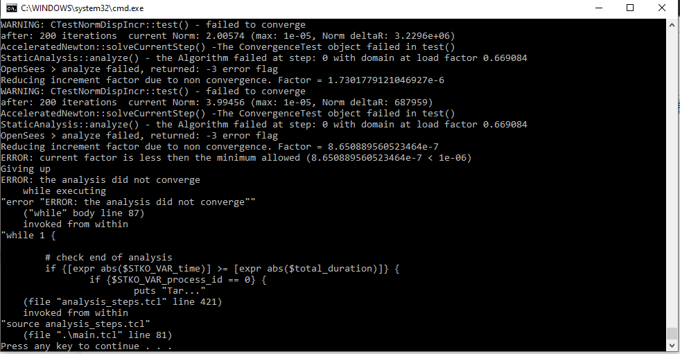

I am writing to ask for you kind support in my problem. I built up my Model (C-shaped RC Wall) tested under cyclic loading, using SFI-MVLEM Element with Concrete CM and steel MPF.
I am facing a problem in the convergence. The analysis runs till a certain % and then fail to converge. So I don't know what could be the problem.
I attached the model. I would appreciate it if you could guide me solve the problem and let the analysis run completely.

Re: Convergence Error in SFI-MVLEM Model
You applied forces and you are doing a load-controlled analysis. But you have softening, so you will not be able to capture the descending branch.
Why don't you apply a displacement history instead?

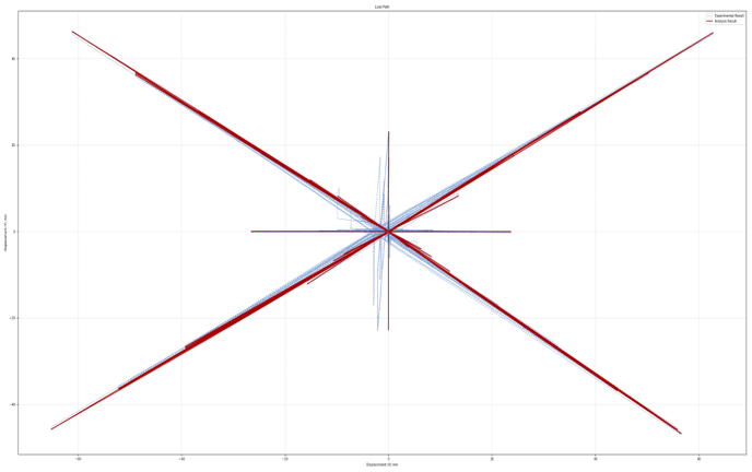

Thank you for your reply. I tried to apply the time series path as a displacement input instead of force input. and changed the analysis integrator to displacement control integrator. But the only limitations in this option is that it specifies the analysis to be in a specific DOF. So if I want to apply a bi-directional or diagonal loading, This couldn't be determined in the analysis.
I am running the analysis in both directions X and Y simultaneously (diagonal). so please advice, how could I consider the diagonal loading in the displacement control integrator.
If you impose a displacement (with the sp) you don't need to do a displacement-control analysis. Just do a load control.
When you have softening you have 2 options (They are equivalent only when the loading point is 1 (top of your specimen), but not in multi-storey buildings for example):
- Impose a force, and control its magnitude with a Displacement-Control integrator
- Impose directly a displacement and do a simple Load-Control integrator
Just change the constraint handler from Transformation to Penalty.
Now you have SP (imposed displacements) at the same place where you have MP constraints (EqualDOFs). This can give problems to the Transformation method.
In cases where the SP and/or MP constraints overlap, just go with the penalty.
In this case, you can use penalty value = 1.0e18. It's fine for your model
