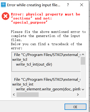

My model has an error as shown in the image, but I don't know exactly where this error is, because I still have an identical model that works. It would be great if you could check it out for me, thank you.

It's because you are using a DispBeamColumInt, try the dispbeamcolumn or forcebeamcolumn.

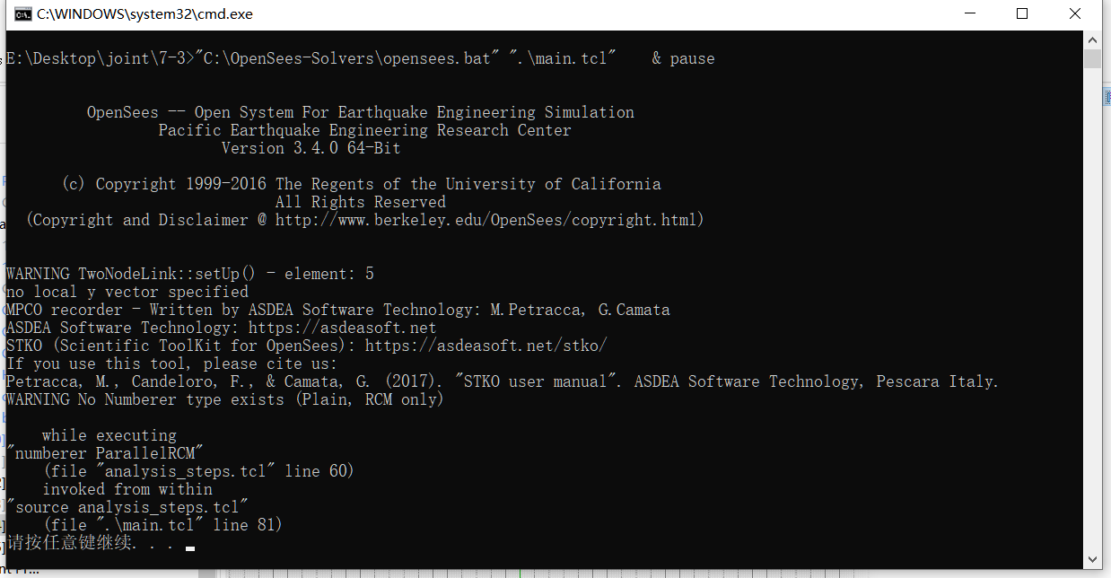

Thank you very much for helping me find this error, but after I fixed this error, I found that it still does not work, I don't know what the error message in the figure means.

It seems you set up your analysis for parallel computing with OpenSeesMP ( I can see it from the ParallelRCM numberer), but you lanched the sequential opensees that does not have that option.
Just use OpenSeesMP
