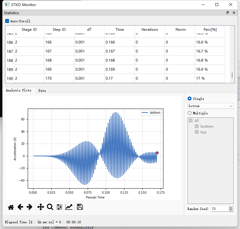

but when I run this example the acceleration time history curve oscillates violently.

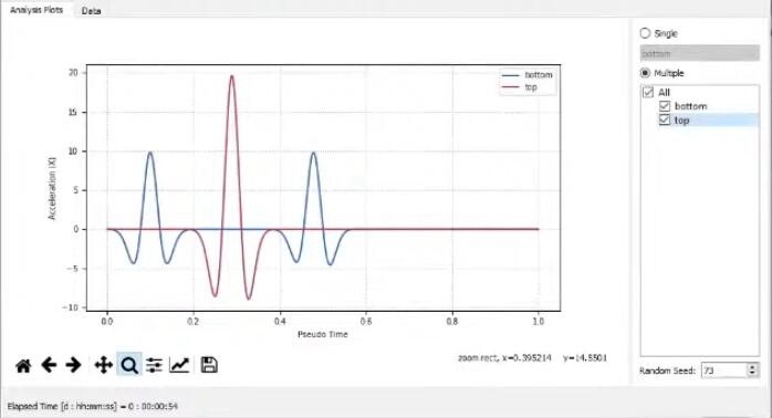

The correct response should be something like below:
This is strange because it is just a simple 2D model with elastic material and absorbing boundary2D. I have checked every parameters are the same as in the video, and the size of the elements are already very small. Can you give me some suggestion about how to fix this problem? Many thanks!
