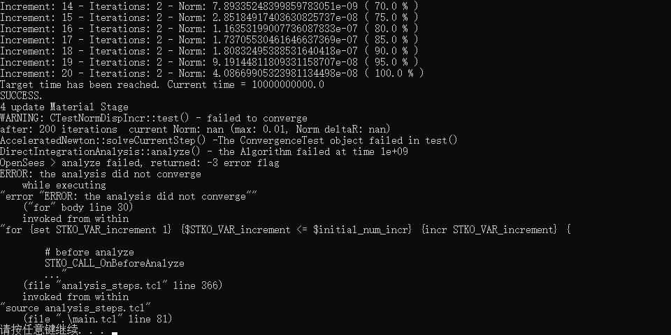

I want to simulate the soil-tunnel system using PM4Sand model, and I develop two numerical models, i.e., a tunnel soil interaction model and a site response analysis model.
The soil tunnel system model is not convergenced during the static analysis when the soil is transfered into Plasticity. The error is elaborated below:
Error for PM4sand-tunnel system.jpg (73.51 KiB) Viewed 10045 times

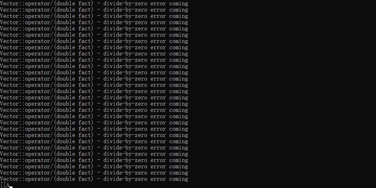

Thus, I built a simple model, in which the tunnel is replaced with the soil. The site response analysis is implemented in the model. When I tranfered the soil into plasticity. The analysis is convergenced, but another error is raised as below:
Vector::operator/(double fact) - divide-by-zero error coming
Error in site response analysis.jpg (172.49 KiB) Viewed 10045 times
Why is these two errors raied? Could you give me some advices?
