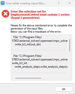

If you try to add BeamSectionProperty to your old file by yourself and you try to run it, you will see this error.
Screenshot 2023-06-01 170258.jpg (35.55 KiB) Viewed 1667 times
The error tells you that in c_node selection set is more than one vertex. To solve it I deleted and created again the c_node selection set. Just this. I saw that it is one vertex now in your model, but something went wrong while you were modeling and you end up with two more geometries stored in your selection set that do not exist anymore. We will look into it, but the solution for you is to delete and create it again as I did. I hope I was more clear this time.
