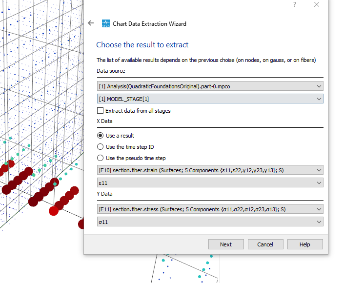

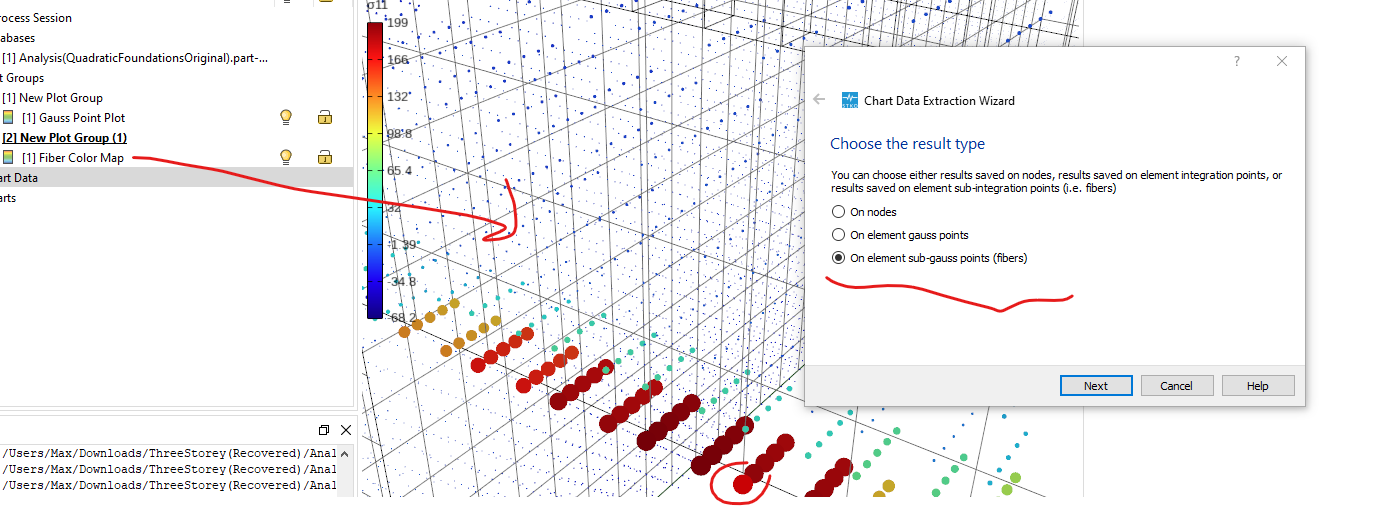

  • First you need a proper plot to select the point for the extraction:
    • For section.force -> use a Gauss Plot
    • For section.fiber.stress -> use a Fiber Plot
  • Choose the proper target, in this case, Fiber
    extract from fiber .png (192.57 KiB) Viewed 2417 times
  • Here you can choose to extract against time or against another result. In this case: strain vs stress
    stress strain.png (78.11 KiB) Viewed 2417 times
