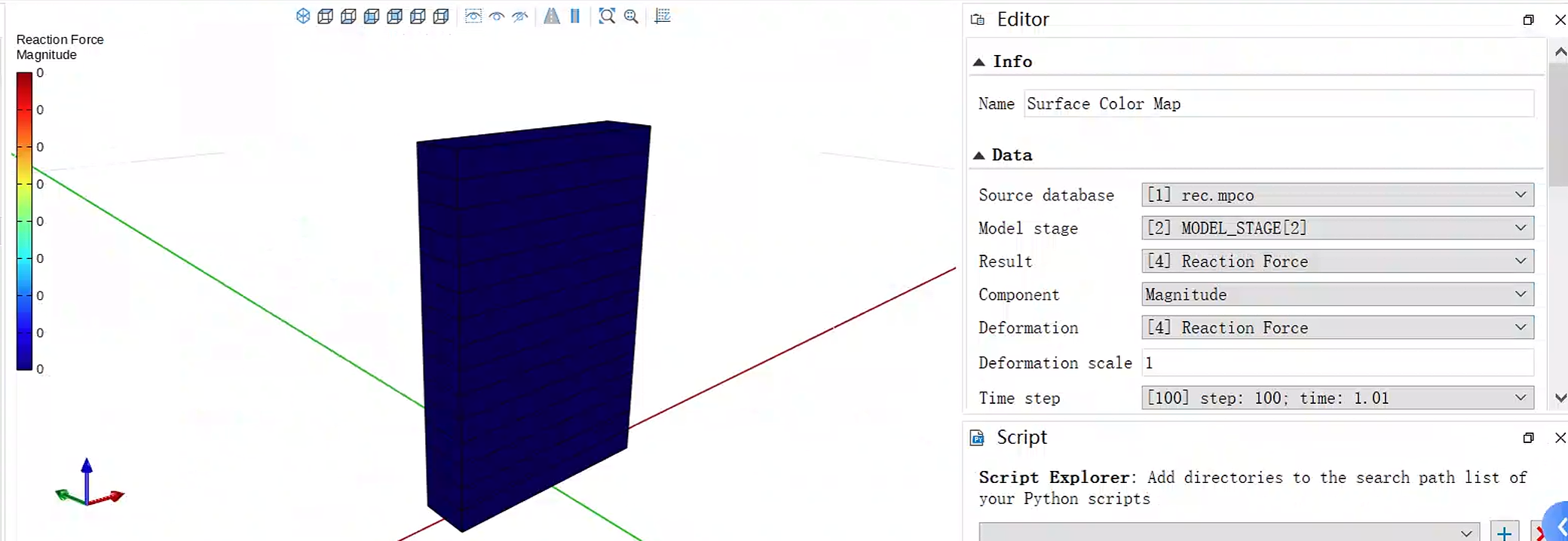

Excuse me, I 'm asking again. The results of the time history analysis of the building model are not ideal, so I took a wall to load seismic waves on it. But I think there 's something wrong with my way of loading that makes the displacement-force curve strange. Can you help me?
Using Pinching4 but the result is strange

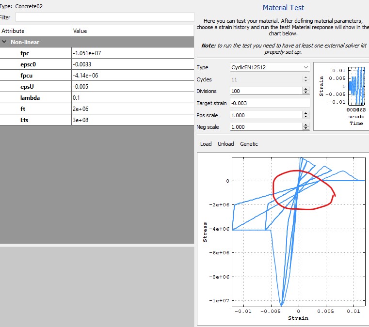

Look also at your concrete material, it has a strange unloading path, probably your lambda is too small, try to calibrate the concrete. You are performing a transient analysis, but you don't apply mass.

Yes i have acceleration in my path timeseries. I make some change on concrete material and i apply mass, but when i apply mass, the model not running. If i don't apply mass,whatever transient and static, use the uniformExcitation or prescribednodalvalue on the top node, the model is running but there is nothing on the result. It 's like no force was appliedValentinaSB wrote: ↑Wed Mar 22, 2023 9:32 amHi Wenyu,

- result.png (691.45 KiB) Viewed 3037 times

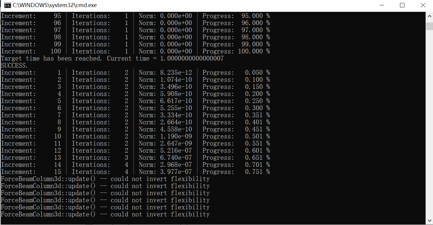

Thanks for you reply, This is the last version, and there shows "could not invert flexibility", I have encountered this warning many times, but it is rarely resolved.ValentinaSB wrote: ↑Tue Mar 28, 2023 2:33 pmHi Wenyu,

There is an overall model of the building structure, but "could not invert flexibility" occurs when the seismic wave is input after the first analysis step is completed.Also hope to get your help.

- running.png (78.68 KiB) Viewed 3015 times

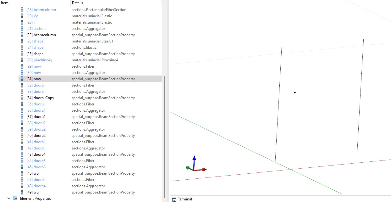

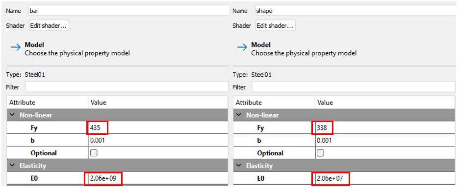

This error can be due to GJ, but I have checked that you have it in all sections. It can also be due to the failure of the material. Let's check first all your materials. Which units of measurement do you use for example for the building model? kN, m? Check for example steel01. Also, check if the assignment of your properties is correct ( you can select the physical property from the tree and show only it, you will be able to see to which elements you assigned it) check for example the physical properties that you called "now". Also, it can be helpful to simplify the model first, to make sure that it is working properly, and then already to add more steps. For example, try to run just vertical static analysis, and if the response is as you expected you can move to the transient one.
