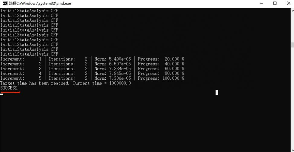

I meet a new problem.
I set the master as the pile-top node and the slave as the bottom side of the cap as you suggested, and I retooled the model so that it can now perform operations.
My new problem is that when the initial state analysis is finished, my analysis step number 10 "update plastic" should put the soil into a plastic state. Then the analysis step number 11 "analysis plastic" should start the plastic analysis, right?
However, the content displayed on my cmd.exe window has not changed and remains in the "SUCCESS" state at the end of the previous analysis. The analysis does not seem to be going on? But in the background OpenSees is still running and calling on cpu resources. Why is this? What should I do?

Post by STKO Team » Fri Mar 17, 2023 11:37 am
It's something inside your material model that takes too many iterations inside the plastic integrator.
Try to run it with a very coarse mesh (subdiv=1) just to see that it runs.
I don't know why, in plastic state, it takes so much time. Probably the material entered a very expensive loop. Double check the material parameters and make sure they are correct
