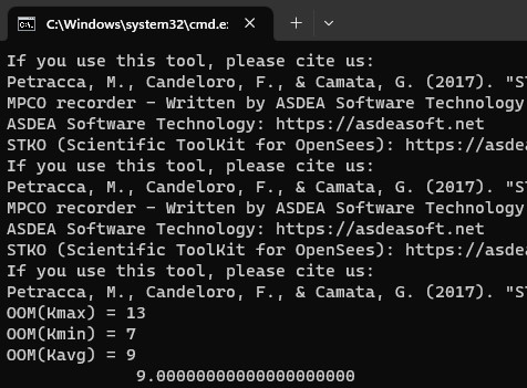

I used it to see your order of magnitude (OOM) of min and max stiffnesses in your model to be able to define the penalty stiffness for the embed element that you used to join two non-compatible meshes. You can also remove it.

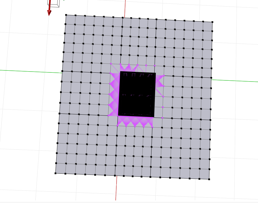

I have redesigned the geometry for the soil model, and now the embed is not fully working. I think theres a chance I might have made the same mistake as before that Valentina fixed, however I'm not exactly sure what the fix was, I have included the embed constraint onto my embed but it does not look like the embed is correctly attatching to the slave nodes. I have redone the selections multiple times but I am still coming up with the same issue, I have attatched the model, and think I might have made an obvious error, or is it simply just visualization glitch.

Here is a screenshot of the embed above when meshed, where only one side is properly interacting

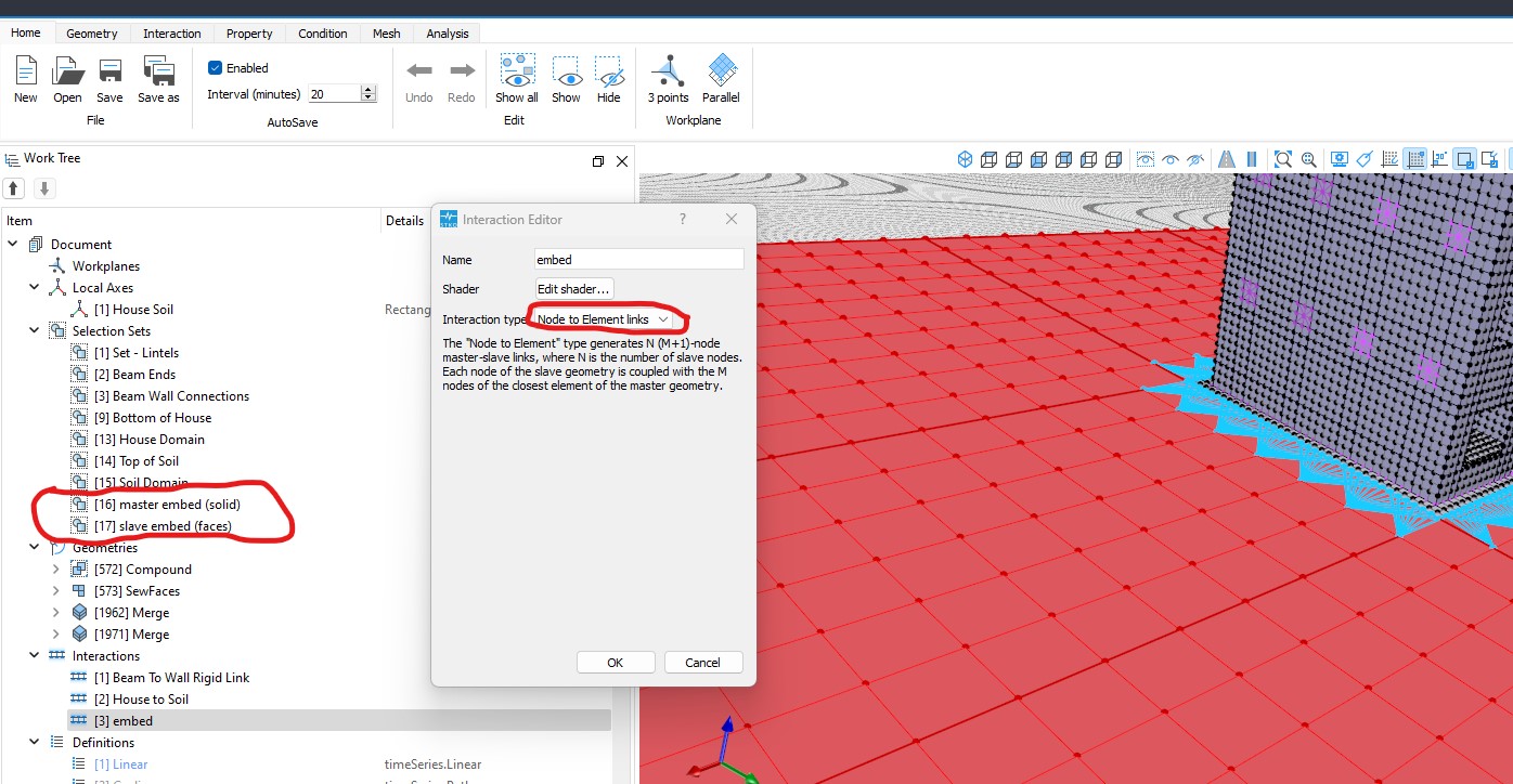

You are not using selection sets, so I can't check how you assigned your embed. Try to use selection sets for this kind of interaction, in this case, you will always be able to check if you did it correctly. Look at your previous model where I added embed before. I used selection sets that you could trace what I have done.
Screenshot 2023-03-14 090608.jpg (240.44 KiB) Viewed 3092 times
  • use the node to element interaction type
  • then your master should be solid of your course soil
  • and the slave geometry are faces of your fine soil
Try and let me know if you need help.

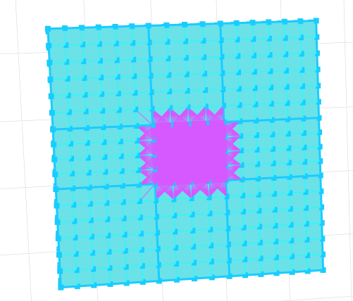

I have redrawn and reassigned everything for the soil domain embed, however as you can see there are still issues as the corners are not properly connecting, I have created selection sets so you can see what I have used to link the two domains, any help would be much appreciated.

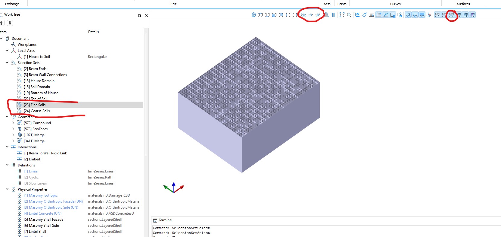

Did you mean these two sets? They are both solids. For the slave you need faces.
Screenshot 2023-03-15 172826.jpg (165.3 KiB) Viewed 3054 times
Use the hide/show buttons, in this case, you do not need to move your building (just hide it). And use selection buttons, select only faces for the second selection set. Look one more time at my example, choose the selection set that I have created, and use the button show only(the center one) and you will see only faces.
