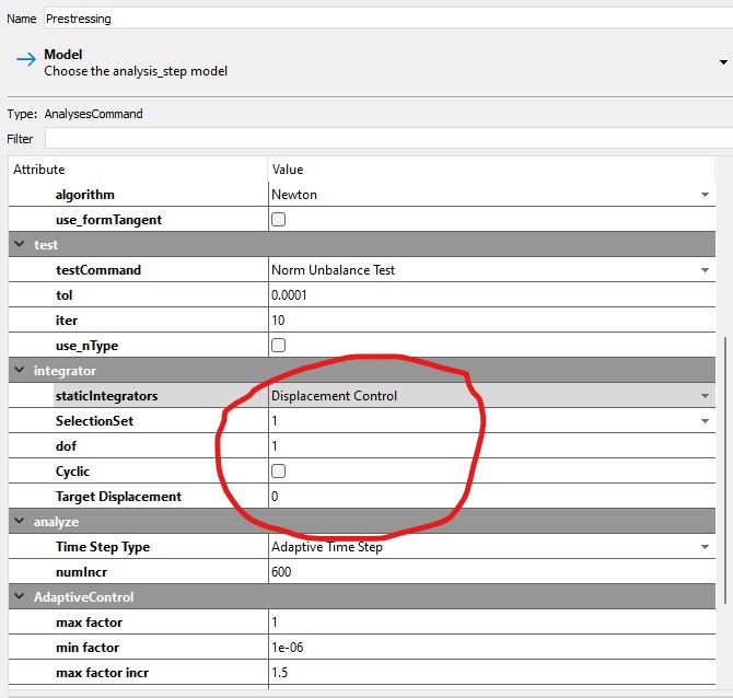

I have a problem with the analysis: I have chosen a parallel displacement control which requires a "point control" set by "selection set". I have identified as selection set the midspan bottom point and I input it in the analysis (as I have already done for similar case study) but I still have a final error that reports I haven't input the selection set.
I attached the model.
Thanks in advance for your help.

The error comes from the first analysis (not the second).
The first analysis is set as a disp control without a selection set. I think you need a load control there

Hi AntoMarinelli,
it gives you the error due to your first analysis (prestress). You also used a displacement control and didn't insert the selection set. If I change to load control it runs.
Screenshot 2023-03-06 093222.jpg (79.04 KiB) Viewed 2809 times
