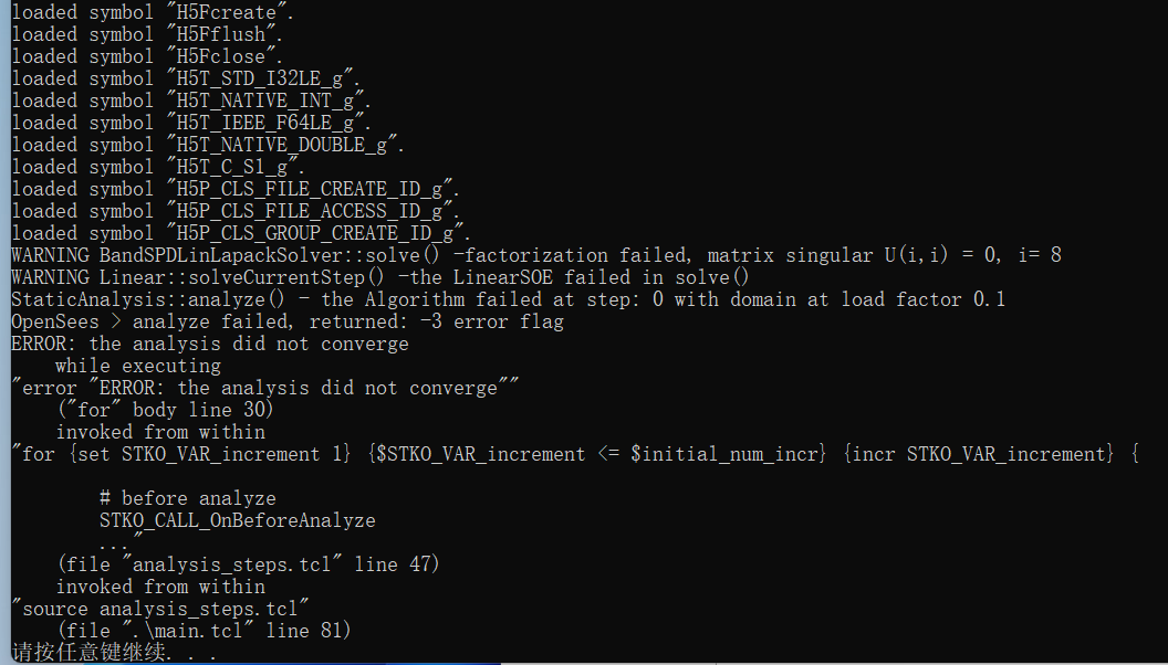

I tried to simulate a tower with Angle steel. i think the Angle steel is truss element. But no matter how I adjust it, it can't run normally, and there is a screenshot. What should I do next?The file is uploaded to the attachment.

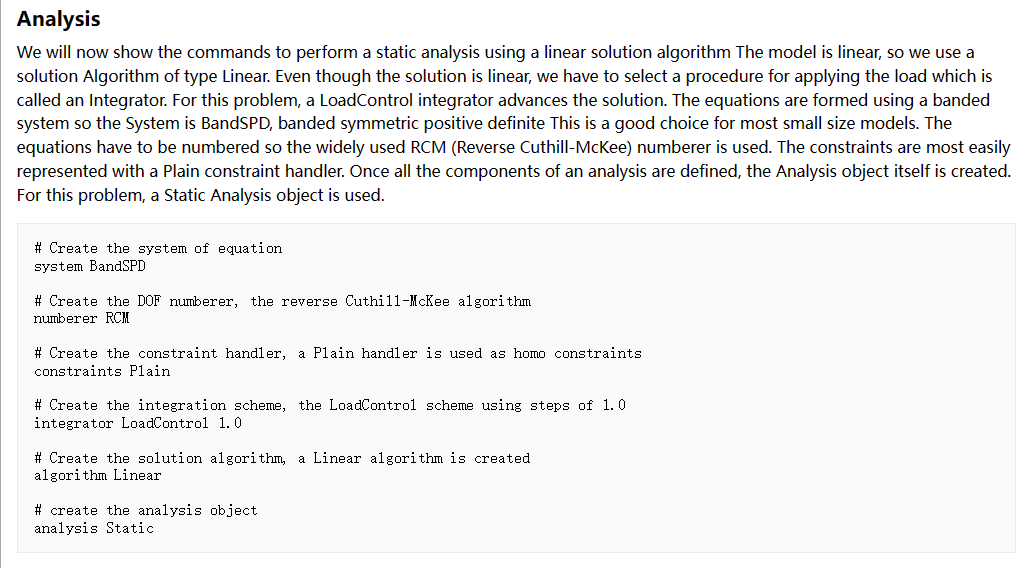

I according the BASIC TEUSS EXAMPLE'S analysis comamands ,if there has any mistakes? See screenshot for details By the way, can you help me check whether there is any problem ?

The error is saying that your model is singular.
If you use beams instead of trusses it runs fine. It means that using trusses creates some rigid body motion/rotation.
Make sure the model is correct and you are not missing any truss.
