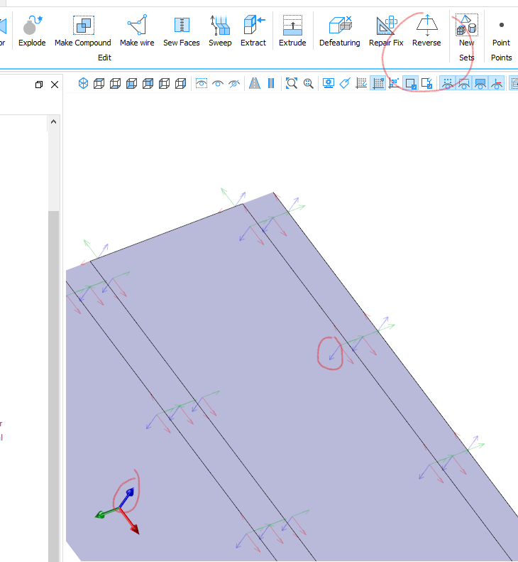

There were few issues in your model:
  • In a 2D model it is important that your local Z vectors point to the positive global Z axes. Otherwise the jacobian of your quad elements will be negative and you will obtain garbage results.
    In your case, you can fix it either by rotating the whole model about the Y-axis, or using the Reverse command
