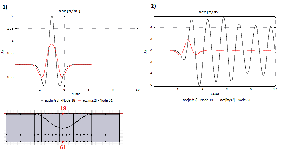

I have one more question if you don't mind:
the results we get are the same as if there was only one layer of bedrock (1); I would have expected something different like what I get in the model I have attached below (2), where I changed the values of:
- Soil Elastic Modulus
- Bedrock Elastic Modulus
- Shear Modulus in Absorbing Boundary
(but these are not the values I should use).
It seems that the first model does not feel the difference between the two layers.
Also, in the second model, I do not find the same ricker wavelet used as input in the base node (2_node 61).
How can I fix these results?
Thanks for your support.
prova5_forum.zip
(863.06 KiB) Downloaded 237 times
Re: Unwanted oscillations in output
Post by STKO Team » Fri Sep 09, 2022 11:12 am
I don't fully understand your question.
However, in the file you sent me, you don't get the expected input at the base just because the bedrock domain is too small.
Given the material properties and the input frequency, the wavelength is about 6 km! you have to make the soil domain larger otherwise you will not be able to see the full wave entering the system:
