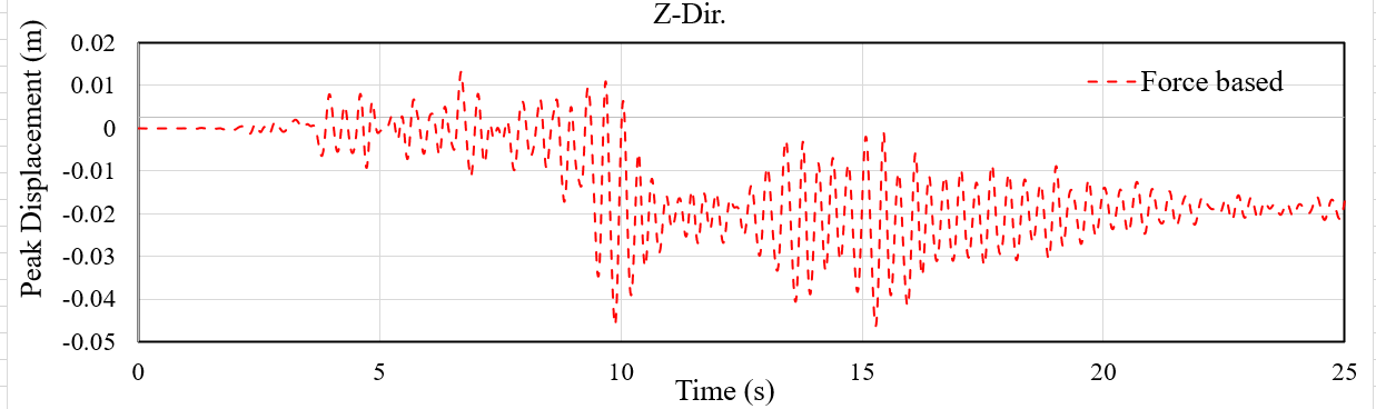

I conducted nonlinear time history analysis on the dome and the observed peak displacement magnitude is higher than the pushover. I am attaching a plot of peak displacement observed for the dome. So if the nonlinear THA response is larger, I was wondering if there is something wrong with the way pushover analysis is happening.
How can the issue of pushover be solved?
Does the issue is related to the loading protocol I used in the pushover which is causing numerical instability?
- THA.png (59.53 KiB) Viewed 2677 times

Well keep in mind that you cannot do a perfect comparison! they are different analyses and the load on the structure is applied in different ways.
In the pushover you are monotonically increasing a pre-defined load pattern, until some member become unstable. In a dyanmic analysis you have a base acceleration which puts intertia forces on the structure in a completely different way, both in terms of spatial distribution and temporal distribution.
But the order of magnitude is the same: 33 mm for pushover and between 40 and 50 mm for transient... is not that different

I get what you are saying. With pushover, I wanted to check how progressive collapse of the dome occurs.
