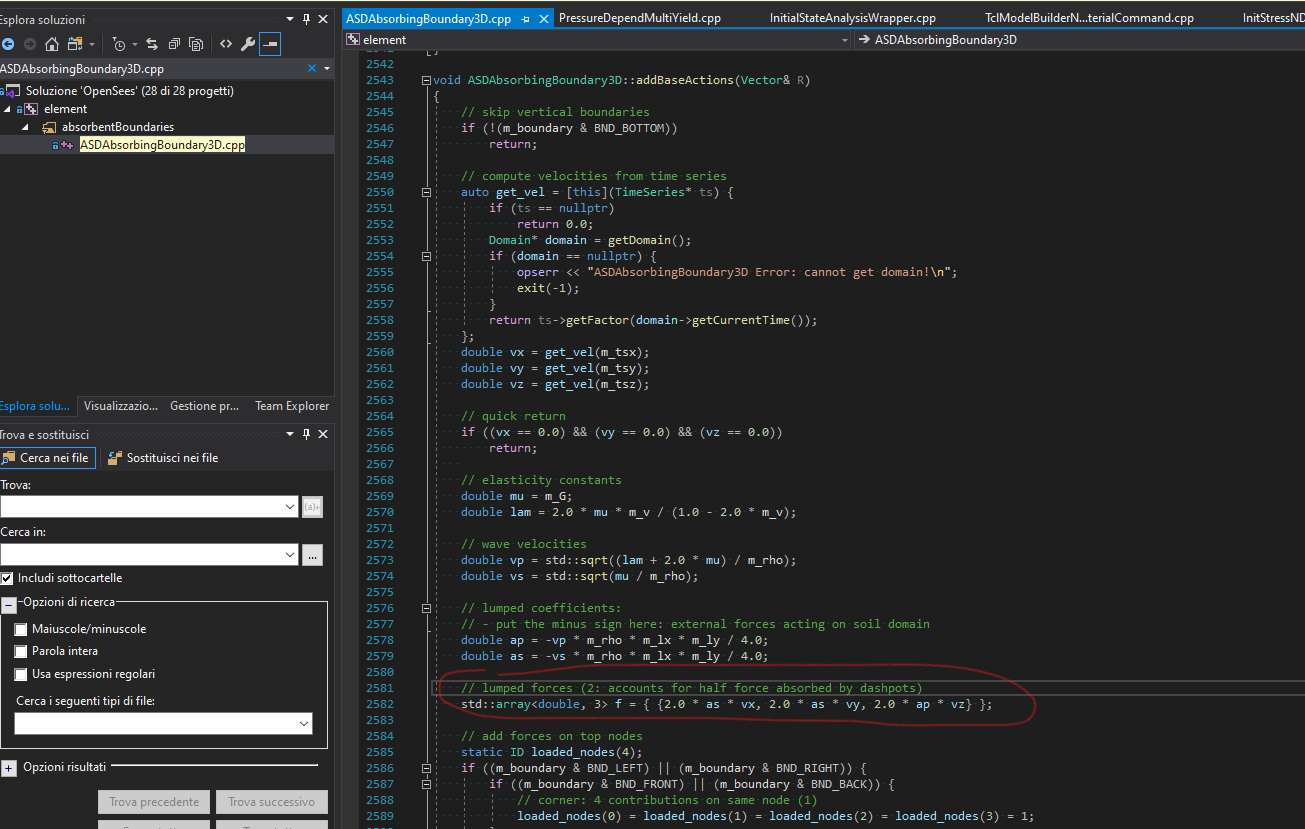

Post by STKO Team » Tue Apr 26, 2022 8:12 am
Regardless of which method you use to obtain the input at the base, you need to apply exactly the velocity you want to see there.
The ASDAbsorbing element takes care of multiplying the input by 2, to account for the half of it being absorbed by the dashpots:
Then it depends on what the software for deconvolution gives you.
