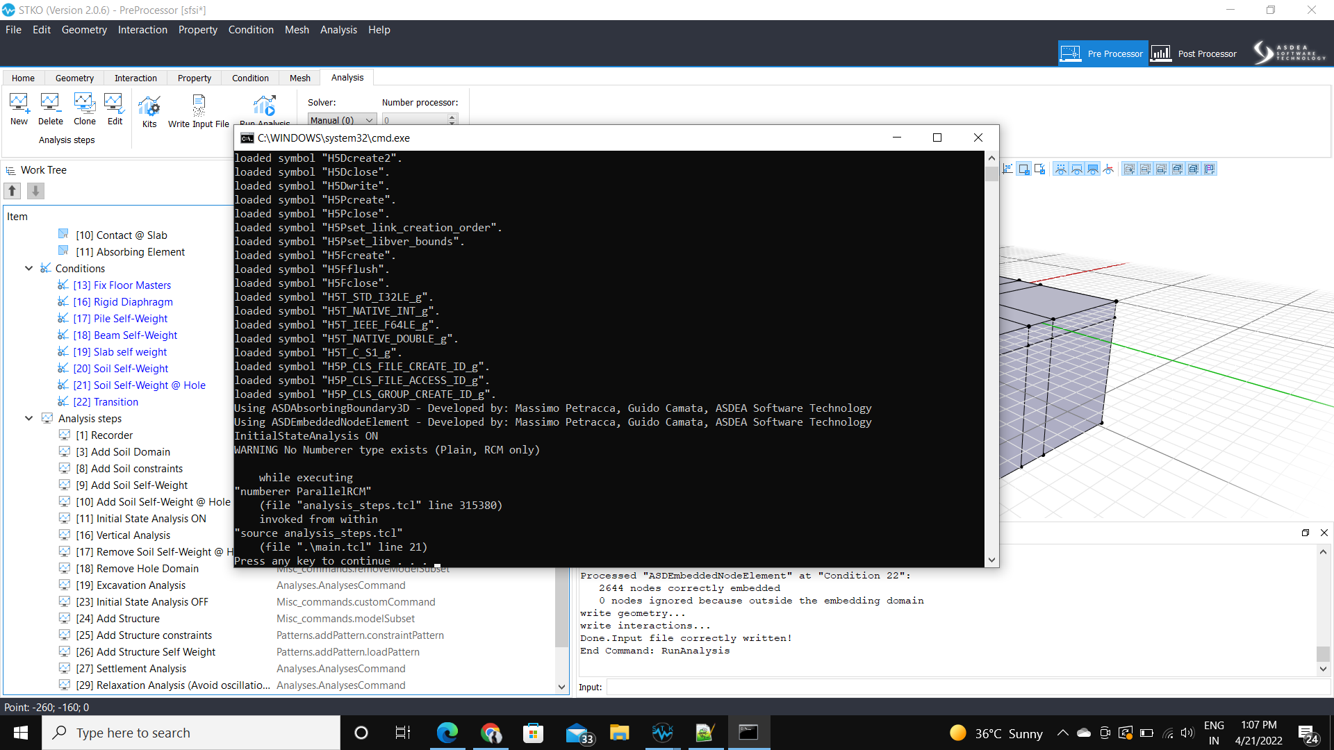

Hello stko team,
while i was running the file you provided in the example of soil pile structure interaction, the following error is obtained. Check you please check it
Thanks and regards.
Screenshot (24).png (326.53 KiB) Viewed 5663 times

The analysis is set for opensees mp, you need to use the mp.
Regards
