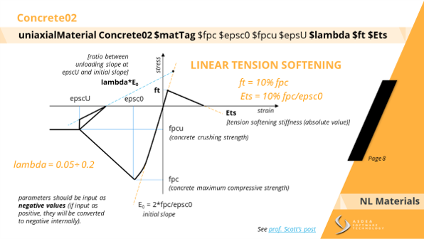

Hi JKLee,
I talked about Concrete02 in week13 of GetStarted with OpenSees and STKO. There are indications to calculate $lambda $ft $Ets. As for $fpc $epsc0 $fpcu $epsU, either you have experimental value or you can reference any norm which normally provides empirical formulations for these parameters (like Eurocode 2)

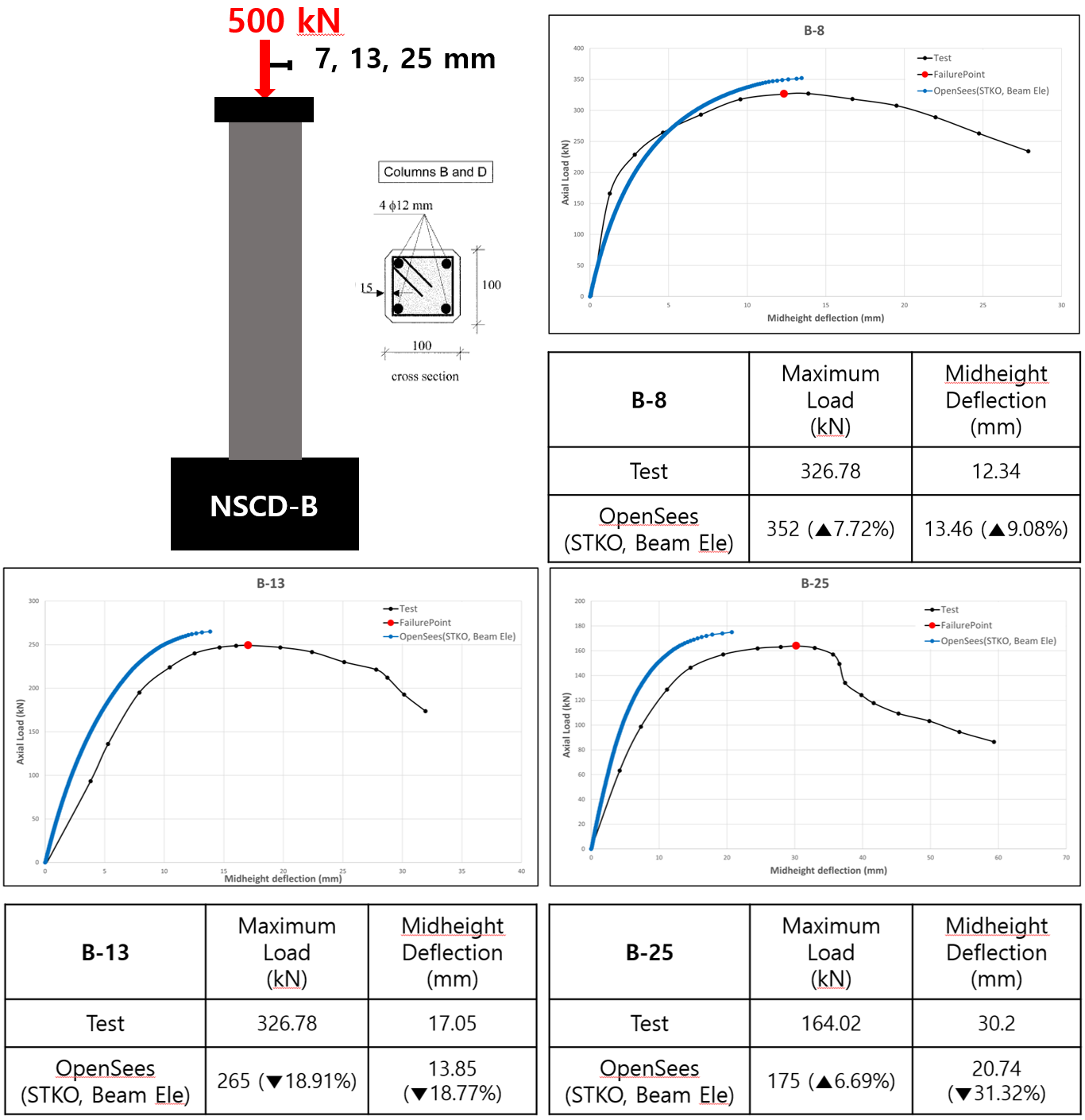

In the ongoing analysis, the results are stiff compared to the experimental data.
At first, I thought it was an experimental problem, but as I interpreted several models, I found that P-delta effect was not considered.

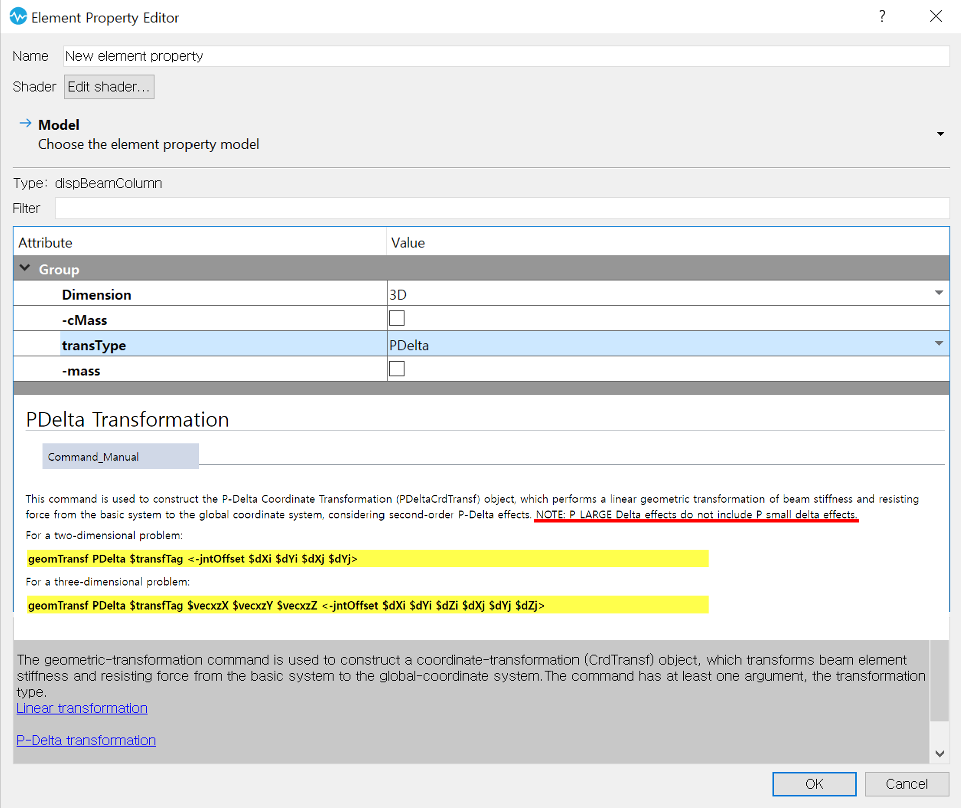

I heard that 'disBeamColumn-transType-P-Delta' considers large Delta and does not consider small Delta, but how does STKO analysis the small delta effect?

To account for small-delta effects you just need to discretize your member, so that P-LargeDelta in every mesh become a P-smallDelta for the entire member.

As can be understood from the Video and Presentation, lambda = ratio between unloading slope at epscU and initial slope at epsc0 = (2*fpcU/epscU)/(2*fpc/epsc0) .......... Eq.1
or lambda = (fpcU/epscU)/(2*fpc/epsc0).......... Eq.2
Which Equation is correct ?
And it can vary from 0.05 to 0.2.
Re: Concrete 02 input data
I don't understand your question... lambda is a value that you choose.
0.1 is typically fine for concrete

Lambda is a ratio. So how to calculate it. Many are using 0.1. But how we got 0.1.
Clarabella
- Posts: 131
Experimental data and literature
