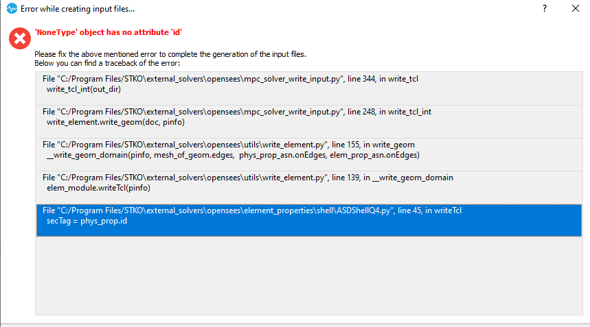

Can you please help me to fix this error? Attached is the model.
NonType Error in ASDEAShellQ4

There is no Physical property assigned to (at least) a face with the ASDShellQ4 element property

Thank you for your reply. Some of the edges had been selected while assigning the ASDShellQ4 element in the model; Actually, only faces should be selected. It works fine now.
