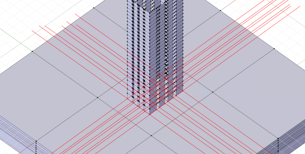

I am working on adding a building on top of the soil domain. I have entered nodes of the building, but I cannot "merge" it with the soil because the geometries dont have common points (Im assuming this is the reason). See picture below - I need to divide soil along the red lines. How do I divide geometry so the soil and the building have common points so I can merge them all into one? Is there a command in STKO that can help me to do this quickly without redefining all soul layers?

Thank you both. I am sorry, but your response is not very clear. What does the embed option do? Are you saying that there is no need to merge the geometries? Is it possible to do what I want per figure I originally attached? Can you please provide more details?
Re: Dividing geometries
If you want to "explore" the "embed" option, i.e. attaching to un-compatible geometries, you can see how we did it in the last webinar with the soil-foundation-structure interaction. In that webinar the soil under the building and the surrounding soil were not merged, but attached using the ASDEmbeddedNode constraint.
Otherwise, if you want to "merge" two compatible geometries, you need to perform "cuts" as per your image.
All you need to do is to create a series of faces in the X-Z and Y-Z planes, for each cut line you've drawn.
Then you can merge the soil geometry with those faces with the "Merge" command.
After that operation, you will see that the property assignments at each layer are maintained.

More or less. The merge option will force you to have the same mesh size, while with the embed option you can also use different meshes (very useful in SSI). The only thing you can't capture is rocking, if you like to capture rocking you need to use the 3D contact interaction we developed.
