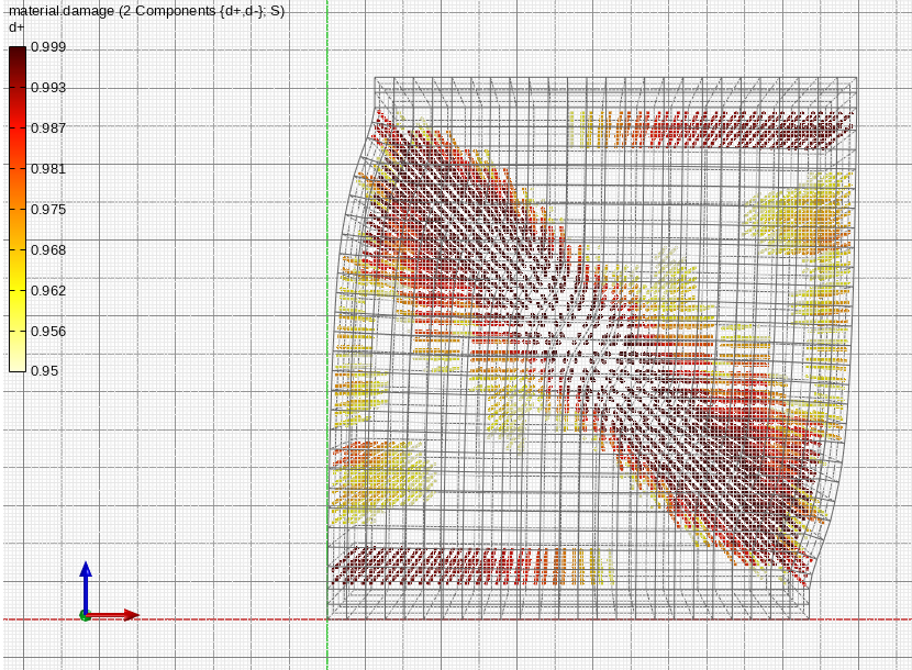

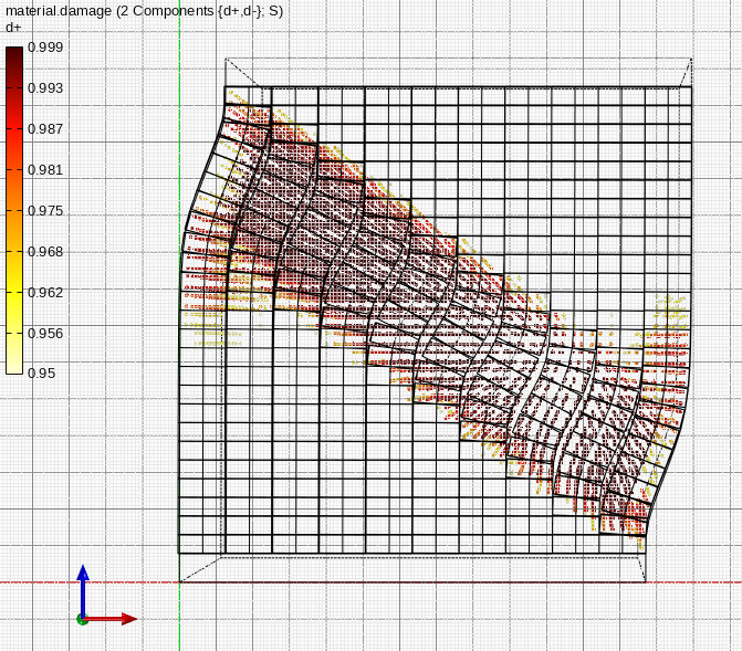

This is the damage:

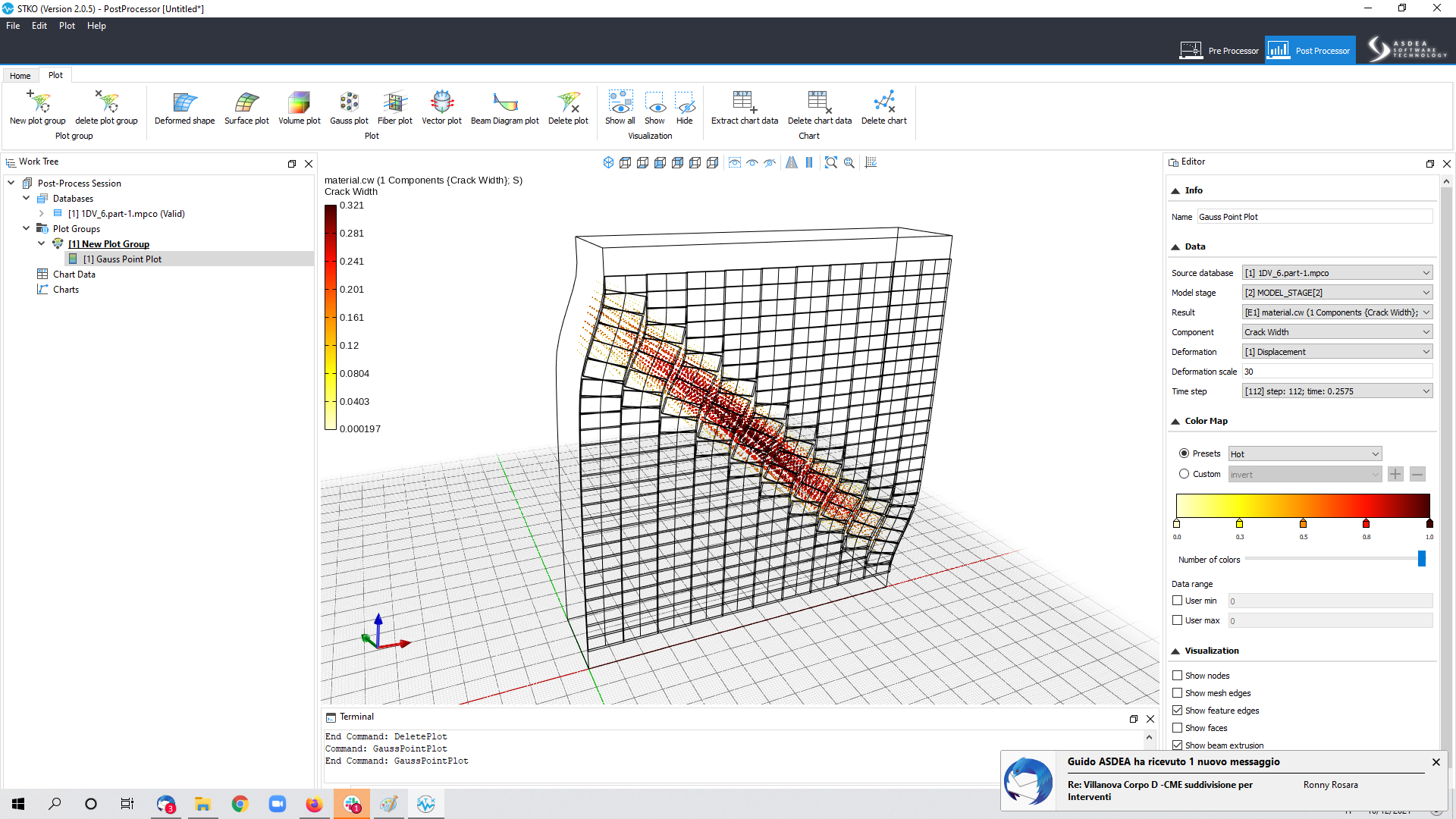

Lately we have implemented the crack width, it is very useful:
You just have to add to the recorder material.cw
Bare in mind that it works with the new stko version and you need to update also opensees
Maybe you can reduce the number of steps to 300/400, try it and see when the number of steps does not affect anymore the results.

attached you will find the results with both strips that is equal to the results you presented in the previous comment followed by the results with the horizontal strips only.

As you know, the horizontal strips increase the flexural capacity and the horizontal the shear capacity. Therefore, if the unreinforced wall fails in shear, adding vertical strips shouldn't increase the shear capacity.
If you are modeling a bidirectional net you should always model both directions as you did. With your assumption the only simplification you make is to assume that the mortar used has zero in-plane shear strength.
Looking at the damage pattern you posted I see that the vertical strips increased the flexural capacity since I don't see horizontal cracks at the base of the panel. The panel fails in shear. In addition, the strut in compression appears to be larger.
The panel with only the horizontal strips starts failing in flexure and then in shear, it is a mixed mode failure.
