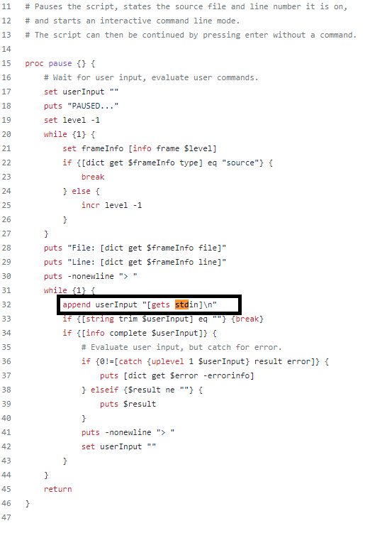

The code works for parallel runs. However, it can not be resumed. I mean, it probably can I just faced a variable reference issue within the code. I am attaching the output from openseesmp as well as the code for 'pause' so you can see where the error occurs. If you have a suggestion on what may be going wrong please let me know.
FYI: I am sourcing the debug.tcl (source for "pause") in the main script and issuing the 'pause' statement using custom command in the analysis steps via STKO.
Opensees output:
Pause source code with stdin variable:

yes, so I guess that command, get stdin, does not work when the script is run on each processor. If you google it you see that in the manual it is not recommended to use it for a parametric study.
As of now, there is no other way that I can think of, I'll let you know if I find something!
Francesca :)

The pause command is used to temporarily stop the Tcl interpreter so that you can query your model or debug it, but it works for interactive mode.
What you are looking for is a method to stop the analysis, save the current state and close opensees. Later on, you may want to start opensees and resume the saved state so that you can start from there... is it correct?
In this case, you should have a look at the DataBase command:
https://opensees.berkeley.edu/wiki/inde ... e_Commands
But I'm pretty sure it will not work well, as it is not mainained from a long time, if I remember correctly

Yes, you are right it can not collect the state from multiple cores at the same time. Thank you for the tip though!
