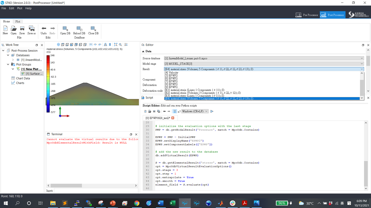

Many thanks for your help, can I check more details with you?
(1) I found that if I have PDMY02 and uniaxial material (zerolength element) in the same model, it will have two "stress" labels (please see E3 and E4 in Figure 1)
If I use the following code
S = db.getElementalResult("stress", match = MpcOdb.Contains)
opt = MpcOdbVirtualResultEvaluationOptions()
opt.stage = stage_id
opt.step = step_id
opt.extrapolate = True
opt.smooth = True
element_field = S.evaluate(opt)
I will get errors like this Error: cannot evalute dataset for result: "material.stress (Lines; 1 Components {σ11}; S)"
Is there any way to figure this out?
(2) if I want to get the initial mean stress,(S11+S22+S33)/3, for each node at the initial step of the last stage, should I do something like this?
opt.step = step_id
opt.smooth = True
SS= S.evaluate(opt)
Initial_meanStress= (SS.setComponentLabels("S22")+2*SS.setComponentLabels("S11"))/3
opt.step = step_id
opt.smooth = True
opt.step = step_id
opt.smooth = True
SS= S.evaluate(opt)
- Figure1.png (255.68 KiB) Viewed 3214 times
Re: Is there anyway to plot excess pore water pressure ratio?
It's because when you use ("stress", match = MpcOdb.Contains) STKO will pick the first result that CONTAINS the string stress in the result name.
Try to use ("stress (Volume", match = MpcOdb.Contains)

ExactMatch = 0
StartsWith = 1
EndsWith = 2
Contains = 3
RegEx = 4
