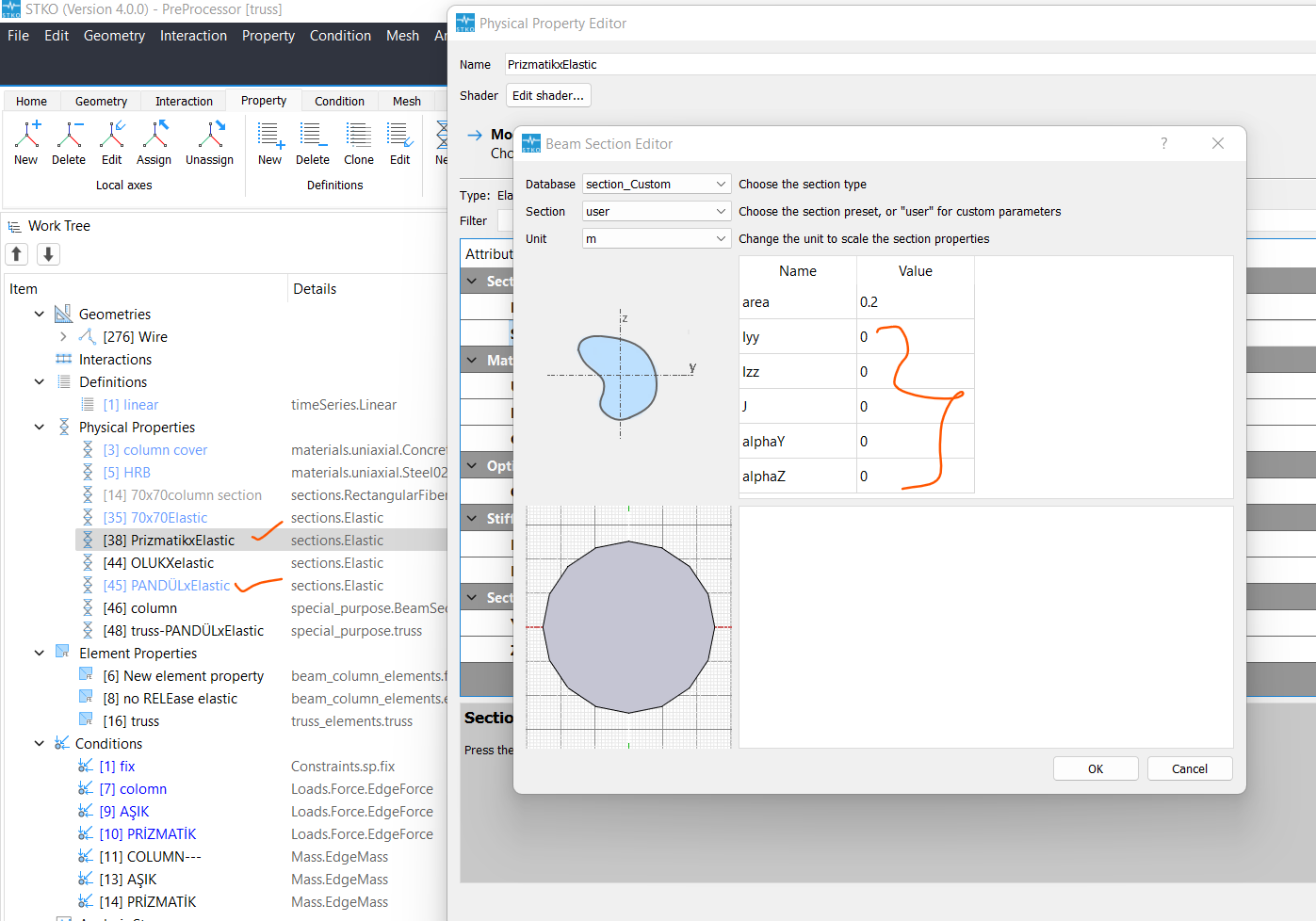

Re: corotTruss element
I have errors which are saying that your model is singular, when I use truss elements. When I use other than truss elements like elastic elements I am not having this issue.
How can I use trusses in this geometry.
thank you very much.
Hi, the main issue in the model comes from the definition of the custom section. The geometry properties, such as Iz, Iy, alphaY etc, can not be zero, as you defined. Please review your section properties.
