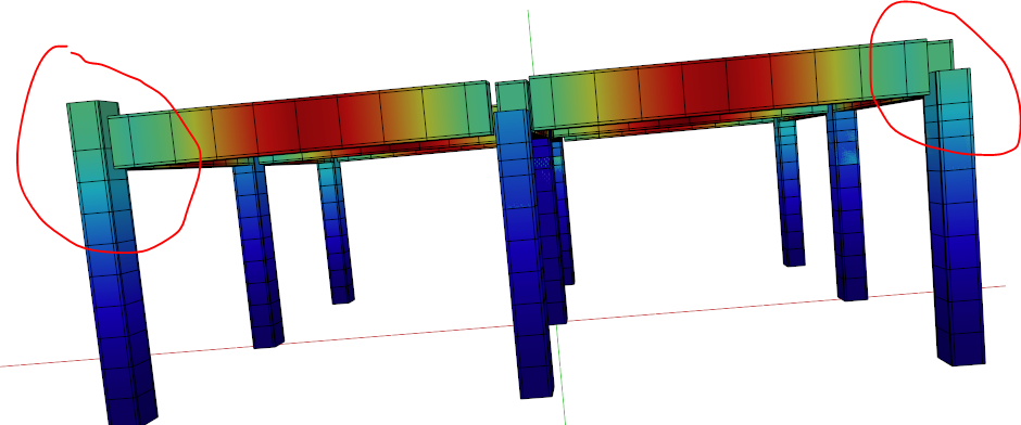

Dear Francesa,
I analysed your model on joints, but I found something strange. I just changed the value of offset in Z direction. The coulmn on left side shifted up, while the column on the right shifted downwards.
. Please correct me if I am wrong.
The model is attached below.
Moreover, I analysed one of the structure using the above procedure for modelling rigid joints only. The time period becomes the function of joint material stifness. As I increase it the time period increase drastically. I am confused which value of stiffness should I use.
Zeeshan
joints (1).zip
(136.68 KiB) Downloaded 142 times

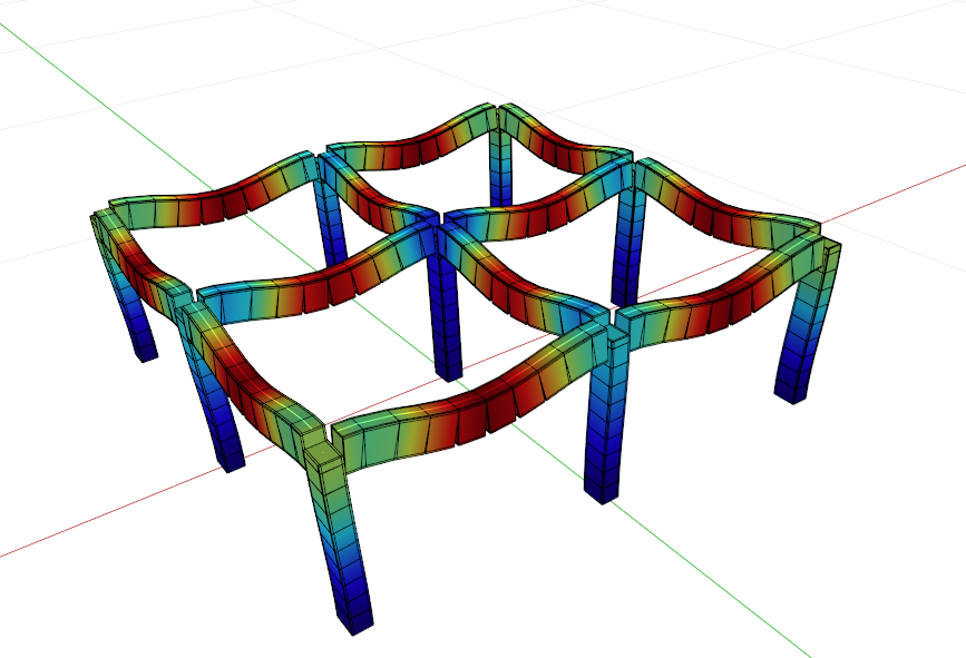

Re: joint offsets
Post by STKO Team » Mon Sep 20, 2021 9:49 am
I run your model with offset values = 0.4 and I don't see any issue:
Immagine 2021-09-20 114856.png (232.33 KiB) Viewed 1147 times
What values are you using?
