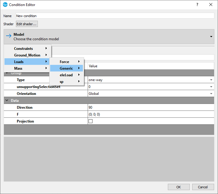

Dear Faruk,
you can use the command surfaceload. See the attached picture Regards

I want to apply the surface load to the floor. But I have just rigid diaphram and master node at the center of diaphram. Lets say 2KN/m2 we have on floors and when I open the condition tab +loads+generic+Surfaceload there are 3 quetions for me
1) one way or two way means that behaviour type of slab ?
2) unsupporting selection set is the area borders of my slab ?
3)and projection box What is it used for?
Regards
Regards
Re: surface load

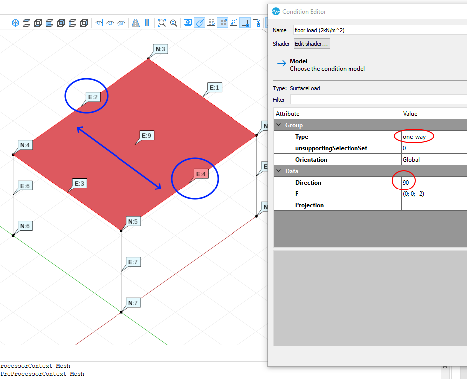

1 way means that the slab is able to carry load only in 1 direction, so only the beams orthogonal to the slab direction will be laoded.1) one way or two way means that behaviour type of slab ?
Sometimes you need to draw internal small beams in your slab, that however are not supposed to carry the vertical load. In this case you can tell the floor load not to put load onto those beams using this selection set.2) unsupporting selection set is the area borders of my slab ?
Projection is only useful when your slab are inclined with respect to the XY plane. By default the pressure load is referred to the real area of the surface slab. If projection is checked, then the pressure load is referred to the projected are onto the XY plane.3)and projection box What is it used for?
Here is an example of a simple 1 floor 1 bay building loaded with a 1-way foor load.
As you can see from the image, choosing 1-way, and direction = 90°, the 1-way slab direction will be = Y, so only elements 2 and 4 will be loaded. The pressure load (2 kN/m^2) will be automatically converted to equivalent beam loads with a Wz = 4 kN/m (since the slab size in the Y direction = 4 m)
