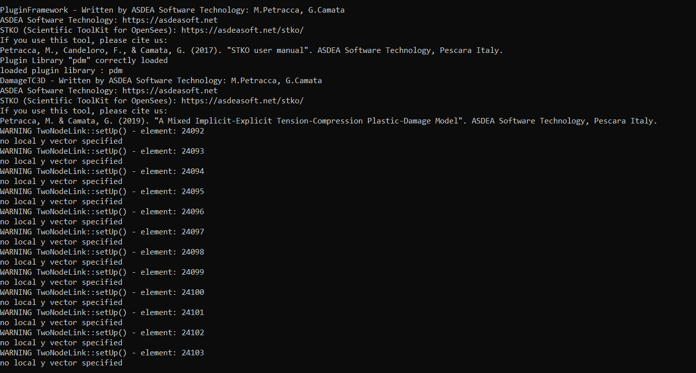

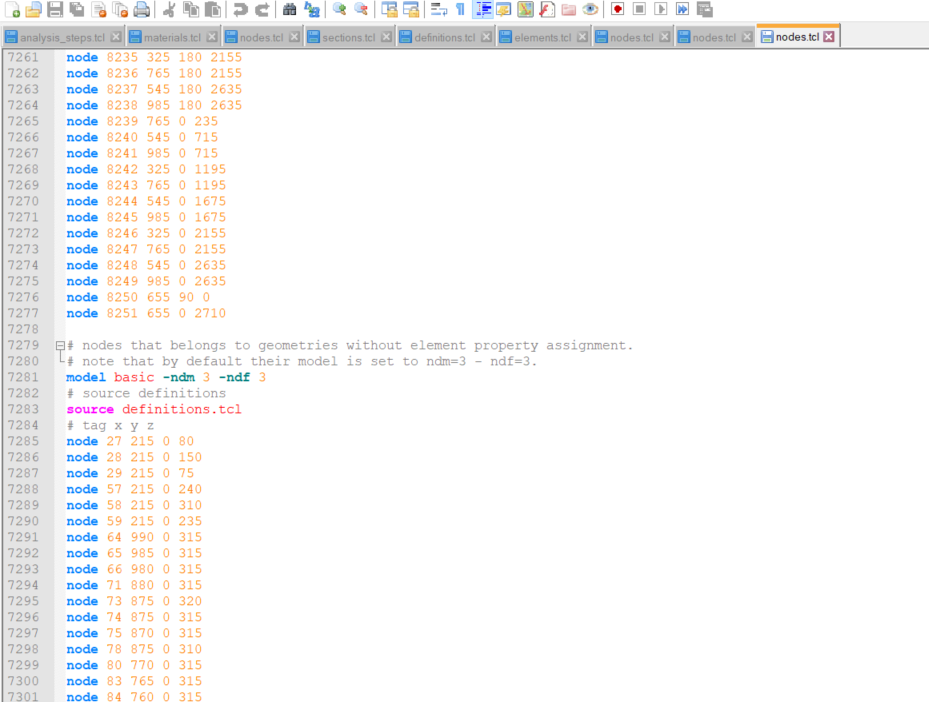

I have created my model. However, in the TCL file it is shown that there are some nodes without element property. I used planar surface for the shell element. I have added some extra nodes on the planar surface in order to assign zero length elements. Also, I have another error which says "no local y vector for twonodelink element'.
I would like to ask you could help me with the error.

Nodes without element property

- Nodes_without element property.PNG (143.58 KiB) Viewed 3995 times
- Two node link error.PNG (64.51 KiB) Viewed 3995 times

It was writing nodes with no element assigned because some faces of one wall did not have any element assigned.
Then I slightly changed the tie connections, to have:

- zero length with pinching on the 2 sides with only the Uy DOFs
- all other DOFs of the zero-length node are connected to shell nodes with EqualDOFs in all DOFs except Uy (better than using stiff materials)

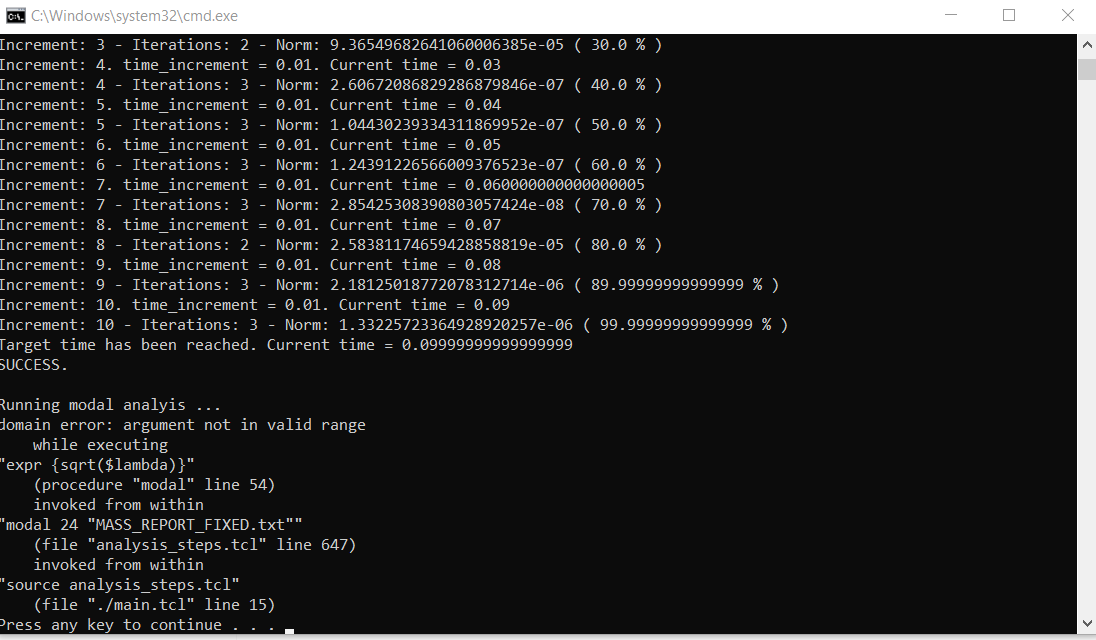

I have corrected the parts that you mentioned (removing the nodal load for time history and adding damping etc). However, I couldn't perform the modal analysis with the script that you posted on the forum (viewtopic.php?f=40&t=1513&p=2642&hilit= ... 6cfe#p2642). In order to perform the modal analysis, I have assigned masses for the leaves using FaceMass. I didn't use any distributed mass on the elements. Is there any other thing that we need to take into consideration?

Sorry, I forgot to attach the error that I received. I also used -fullGenLapack as eigen solver in the analysis.

- modalerror.PNG (48.13 KiB) Viewed 3961 times

The error says that the lambda in sqrt(lambda) is not in the valid range for the sqrt funciton. It means that you have a negative eigenvalue. It can happen when your model is not well constrained, or when you run an eigen command after your structure goes into a softening stage.
Make sure your model is well constrained. If I recall properly, your model was not constrained in Y.
