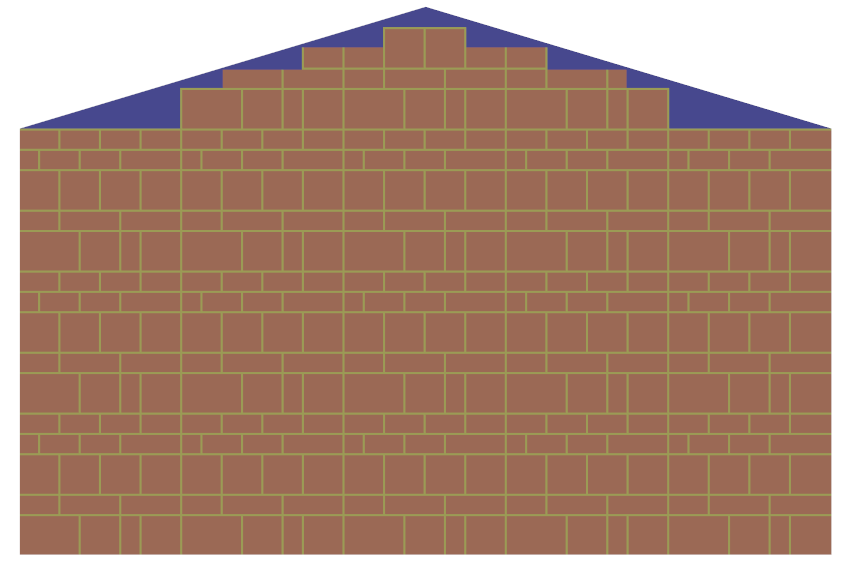

I had a look at your model and the geometry of the transverse walls where corrupted (probably due to not-so-accurate boolean operations). I changed them so that now they can be meshed. If you remember, during our meeting I told you that it is better to keep the top portion of the transverse walls as homogeneus, since it will be difficult for you to generate valid geometries for structured quad mesh (it can be done, but you need to master meshing techniques). This is how I changed the transverse walls, the violet geometry has an homogenous property, that is a mix of mortar and stone (obtained with a layered shell section with alternating layers):

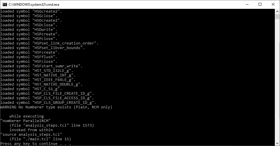

I figured out my previous question by not assigning "homogenized 3d" any element property. I am running into this now
I am thinking I got some parameters incorrect or some other errors.

Post by STKO Team » Sat Aug 08, 2020 11:14 pm
Hi Alok,
That error is caused by the fact that the file is set up for OpenSeesMP (in fact I used the ParallelRCM numberer). However you tried to run it with OpenSees (that of course does not have the parallel numberer).
So if the file is set up for Parallel analysis with OpenSeesMP (parallelRCM as numberer and MUMPS as system, and ParallelDisplacementControl instead of DisplacementControl if you need it... ), you just need to partition the model after meshing, with as many partitions as the number of processors you want to use. Then just change the active solver to openseesmp and run it.
