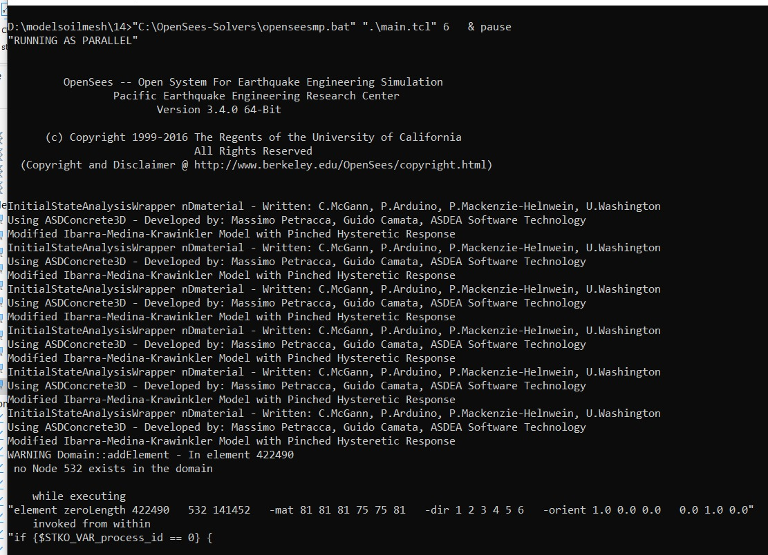

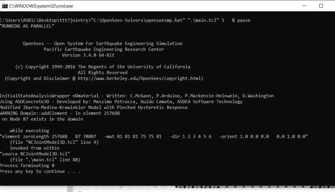

dear STKO, can you help me to solve this

It is saying that a Node used by an element is not in a domain. how many partition have you done in the STKO model?

Re: RCJointModel3D at Geometry
Post by [email protected] » Wed Jul 29, 2026 8:25 am
thank you for your replay, i did 6 partition i send you the model can you please see it
Post by STKO Team » Wed Jul 29, 2026 11:13 am
That's the reason why it was giving that error.
You did 6 partitions, but from the image of the Command Line you invoked OpenSeesMP with only 1 partition. So OpenSees is "seeing" only 1/6 of your whole model
Post by [email protected] » Thu Jul 30, 2026 12:49 pm
hello, i did now 6 but same error
