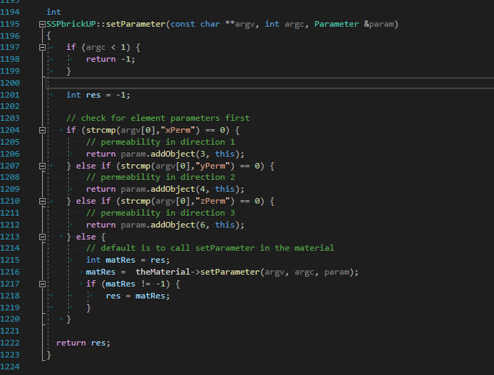

Post by STKO Team » Mon Jun 08, 2026 7:43 am
Unfortunately, the SSPBrickUP (as opposed to the others) only supports: xPerm, yPerm and zPerm parameters, as you can see from the source code:
