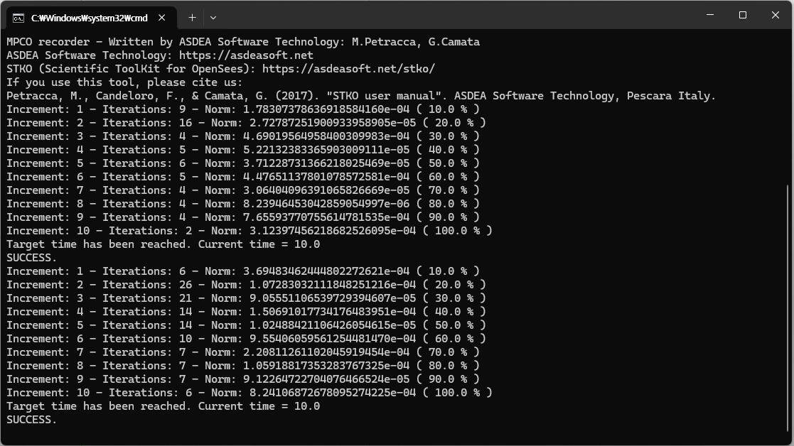

Dear STKO support team,
When I click the 'Run analysis' button, the process seems to complete up to 'Gravity-LE' and 'Gravity-LE-Water' as shown in the attached image. However, the analysis seems to stop at 'Gravity-NL' without displaying any error messages.
Could you please help me resolve this issue?
Best wishes,
Youngkyu
Best wishes,
Youngkyu

Re: Analysis error while creating input files
If you look at the output of the first 2 stages you will see that the dam is floating.
can you try to add both mass and self weight to the dam?
