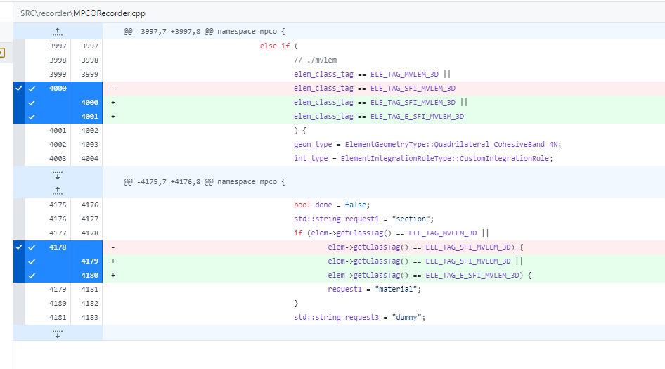

  • Finally for a proper visualization you need these changes in the MPCORecorder.cpp file in OpenSees (we will do a PR soon):

In the meantime you can try to put those 2 modified lines in the mpco recorder in your local opensees source and compile it
