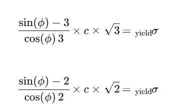

Thank you for your response. I am familiar with the existing constitutive models in the software, such as PDMY, etc., but since they require a lot of input parameters and I believe calibrating each model to match the soil layers at the study site would be time-consuming, I decided to use a simpler constitutive model. Can I use the attached relationship to obtain the yield stress using cohesion and the friction angle?

Re: Constitutive model
Check the opensees documentation:
https://opensees.berkeley.edu/wiki/inde ... ker_Prager
Under the Notes:
Under the Notes:
The Drucker-Prager strength parameters <math> \rho </math> and <math> \sigma_Y </math> can be related to the Mohr-Coulomb friction angle, <math> \phi </math>, and cohesive intercept, <math> c </math>, by evaluating the yield surfaces in a deviatoric plane as described by Chen and Saleeb (1994). By relating the two yield surfaces in triaxial compression, the following expressions are determined

Can I use the yield stress formula in both three-dimensional space and plane strain two-dimensional space?
Yes, after all a PlainStrain material in OpenSees is generally a wrapper around the 3D one.
